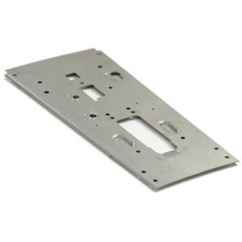

  4. HK_User
    Banditos use to have them ready to bend. I passed.

  9. Seacowboys
    I built this Yugo underfolder on a stamped reciever and just don't like it, it doesn't run as well as the Romies I built for some reason.
    Tully Mars likes this.
  10. Tully Mars
    Was not aware of this. I've always been told that if the kit was from a milled receiver weapon it would only work with another milled receiver. One of the reasons I've had these kits for so long.
  11. ghrit
    I bought the receiver already shaped/bent. For sure, doing the bending would be a LOT more work. In any case, if the trunnion dims match, you're good to go with sheet metal. Be aware that there are (or were, back then) two thicknesses available. Bear in mind that it is the inside dims that are critical for fit and function.
