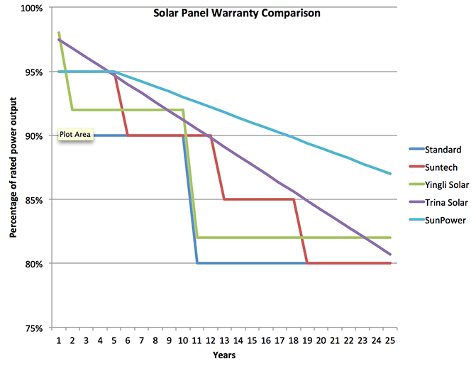

  6. chelloveck
    How old is the panel?? Solar panels don't last indefinitely, and they do progressively degrade in performance over time.
    The Real Lifespan of Solar Panels - Energy Informative
    also check for corrosion of connectors between the supply cable to the batteries. As with motor vehicle batteries, corroded connections can affect system performance.
    https://www.nrel.gov/docs/fy12osti/51664.pdf
    Solar panels don't last forever and degradation varies wildly, study says
