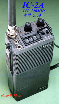

    If you have a ham tech level ticket, buy a couple of ICOM IC-2As. They came in 2 meter (144 MHZ) and UHF.
    No programming - just dial up the freq. Covers on the ham band of choice. 1.5 watts - and built like a brick outhouse.
    I got a working pair that looked new for $35 at a local hamfest. Battery works for an all day (90% RX) and they are stable in both hot and cold wx.
    Good luck.
    Edit to add
    Battery pacs and AA battery trays are still made/sold for your use.
    ICOM is just one of many vendors.
