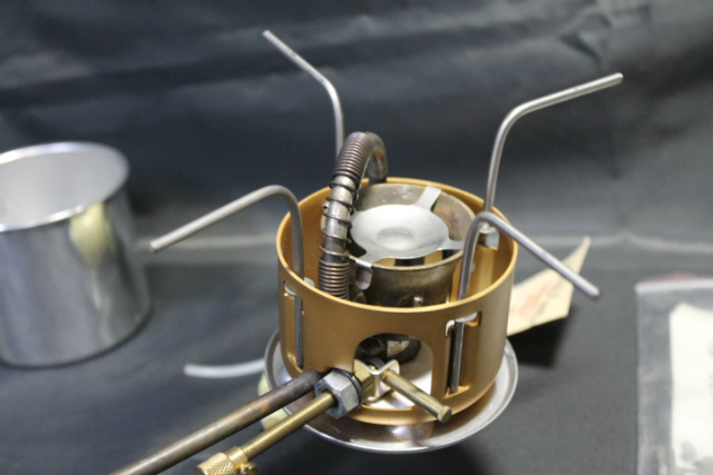

    MSR XGK, old style, from 1981 to 1994.
    There are variations on this - mine has the generator wrapped in wire like this example, early release versions are not. Mine was also this clean - once upon a time....

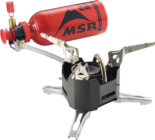

    the MSR XGK EX - whow!

    The XGK-EX is a stove that does one thing very well, and that is melt snow. It is very durable and easy to maintain. It is also expensive at $160 for new.
    The stove is fuel efficient, and produces high BTU output at altitude. It also will not simmer, it simply was not meant to do that. This is an expedition stove, not a backpacking stove.
    Having said that, I got mine for two reasons. To melt snow and to use any fuel I might be able to obtain in Bush Alaska. The burner has two orifice (tips) one for Gasoline and one for kerosene/diesel. I know many aircrew types that packed one of these in their RON bags. Eating cold rations is no fun in the snow.

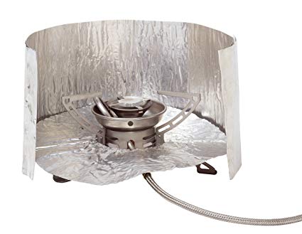

    The XGK windscreen was a radical departure at the time of introduction and is still the key to fuel efficiency. This is also why the fuel bottle is separated from the burner.
    The same style windscreen is used on other MSR stoves, all with separate fuel bottles.

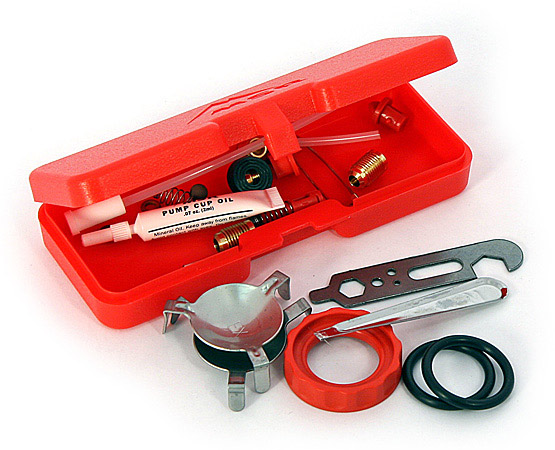

    Spares kit (red box) - buy it with the stove, this is a no-brainier! Ditto on a spare pump body if heading out of country.
    The metal gizmo with holes is a snow support leg kit. Ya. Above the treeline - nice to have but a metal food plate will work as well.
    Close up of spares kit

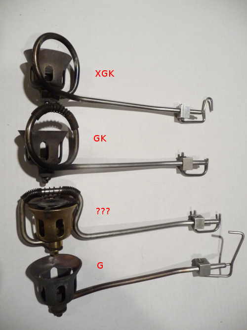

    Evolution of the burner over time/model type.
