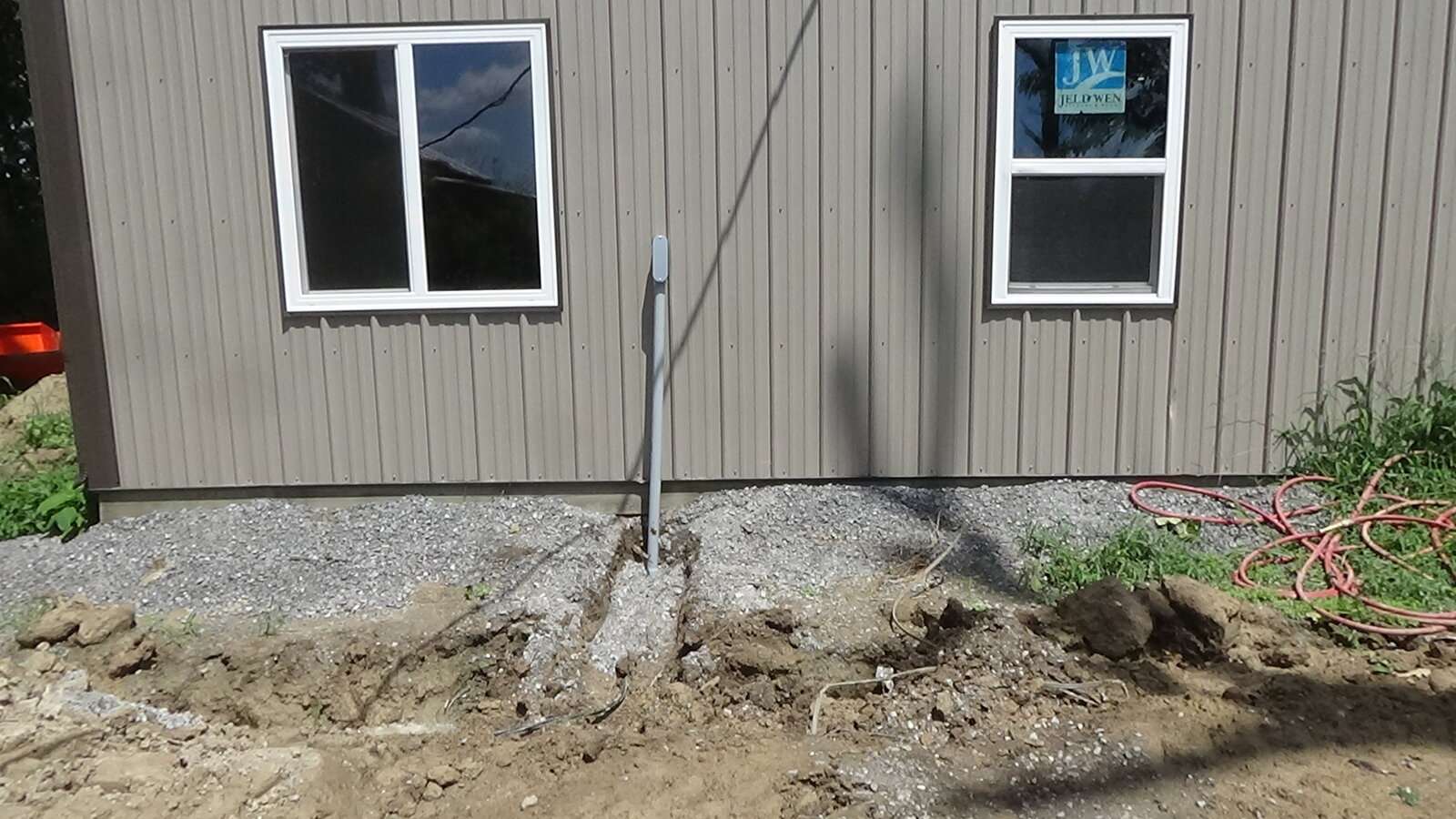

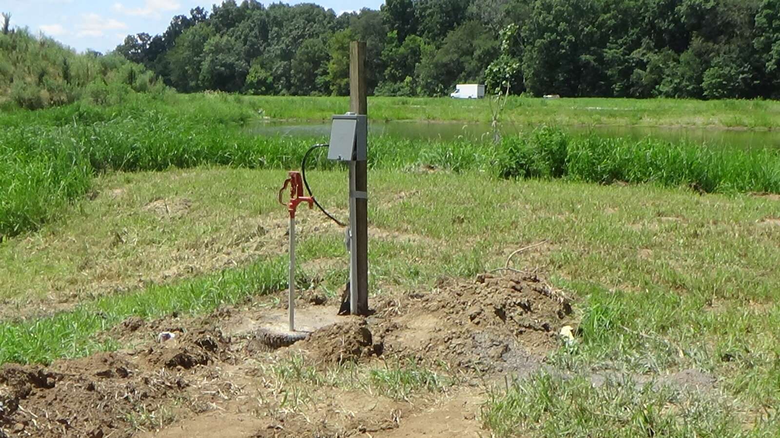

    Finished it up this morning except for cutting a 3/4" marine plywood rectangle to bolt onto the post behind the breaker box. To mount my switch and outlet boxes on to. LOL 600 pounds of quickcrete holding the post down. And used a rear garden tractor tire with a cut sidewall for the around the hydrant concrete.
    Ed my Electrician friend is coming in the morning to deliver a 60amp welding whip he built for me and is going to connect the ends to the breaker boxes. I have a firm rule that I don't wire feeds into the boxes and I don't mess with cable bigger than 6 gauge.
    Going into the house was easier than expected. Cut the hole out perfect first shot. LoL I am usual 1/32 inch off and have to wrestle the threaded conduit through. A straight shot into the box was very nice! I had to go at a slight angle up the wall because the big 600amp main line is right beside the base of the conduit on the right. DSC00349.JPG
    Ed did the math on current and amp loss over the distance and comes up with I will be able to safely pull 59 amps at the pond box. He figures I will lose 2.5 amps per 100 feet of cable. I can live with that :) The 5500GPH pumps pull 5 amps each. The LED lights will pull like 4 amps for A LOT of lights. SO 14amps to those things. I am going to put my camper (The Krap Kave) out there. I am just going to hard wire its breaker box to 40amp breaker in the box with 6gauge and call it a day. And that leaves me 5 amps to spare if I want to put another pump in for a stream, fountain or another waterfall. Actually more amps since the Krap Kave runs on a 30amp breaker from the cabin with 10/2 wire. I only blow the breaker when I have both air conditioners running, the coffee pot. The Desktop and forget to turn a AC off when I turn the microwave on LOL.
