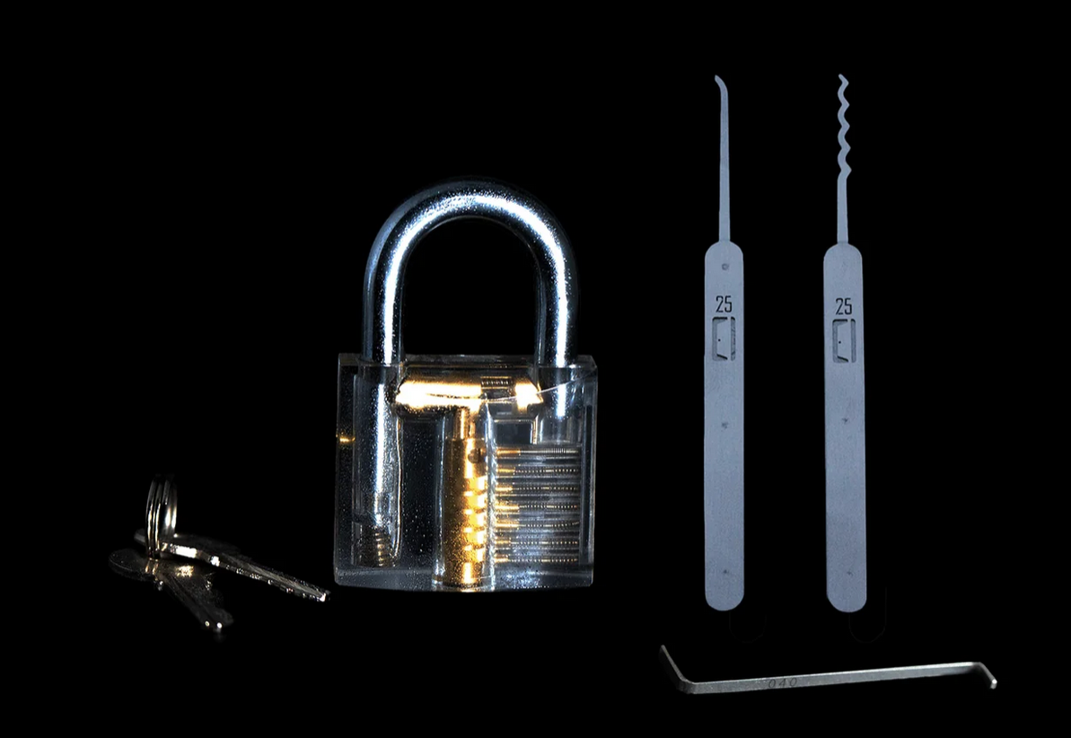

    After testing several kits and quite a few picks from several vendors, I have decided to come up with one, recommended kit for EDC or to compliment a bug out profile.
    DSC00008.JPG DSC00005.JPG DSC00006.JPG GHO-PS-ENP. tension.
    For the full description of each item and links to where to purchase this lockpick set, see the resource .pdf -- LINK HERE.
    The lock pick set I recommend is comprised mainly of an EOD set made by Sparrows, along with your choice of any specialized hooks and tension wrenches, and a Peterson pry bar. You may use the Sparrows pry bar tension wrench as a suitable alternative.
    The kit I finally came up with is based on ease of use, where it is necessary to keep the kit light and thin so as not to cause unnecessary discomfort. I also had to stress test these items to ensure they will not easily break, and I have been very pleased to discover this is money well spent. This kit is heavy on rakes, to promote faster picking for quick access if needed. I removed some of the tension wrenches which comes with the EOD kit and added the pry bar to make 4 wrenches, total. Your mileage may vary.
    final_edc1.
