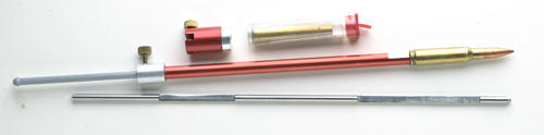

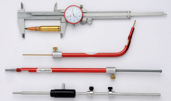

    Consider an Overall Length Gauge as well. My .308 went from useless to my favorite bolt gun because I bought one.
    Gator 45/70 and duane like this.

    There is a gauge that will show if your reload is being sized to standard and a caliper will give you overall length. They say that in a sense it gives you your head spacing as the fired brass will form to the actual size of the chamber. Real handy in setting up the die when reloading and makes standard ammo out of once fired brass. .L.E. Wilson Case Length Headspace Ga 22-250 Remington https://www.midwayusa.com/product/101827769
    I find them very handy when reloading range brass or buying bulk brass that hasn't been resized or even checking resized brass.
