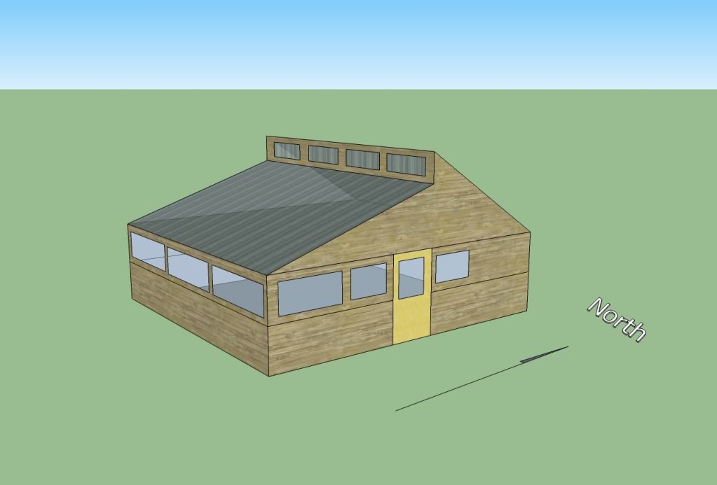

  6. VisuTrac
    Ok, below is the concept drawing. design is subject to change due to length of wood and size of discarded windows that can be scrounged.
    plan on using clear corrugated roofing on south roof.
    this is gonna be rustic :)
    drawing not to scale.

    my only concern on your design is the clear corrigated roofing. I built a greenhouse with the fairly lightweight very clear (some sort of plastic) roofing, and in a couple of years time the hot sun here in florida actually cooked, discolored, curled the edges, and made it very inefficient as a winter greenhouse because it leaks rain in and air out like a sieve. I know they make a corrigated fiberglass product in blue, green, and white that is translucent, but not clear. It might be a better product to consider for the roofing. JMHO.
  10. TnAndy
    My recommendation is bite the bullet and buy double or triple wall polycarbonate for the insulation value and longevity.
  11. VisuTrac
    TNAndy .. That is sweet. Way over my budget. my goal is to spend less that 200 dollars and most of that is going to go into clear roofing panels.
    I'm starting this weekend as it should be about 25 degrees cooler this week end in MI.
    Great job on your GH/Solar Power Shed [clp]. My greenhouse hopes to be that when it grows up.
