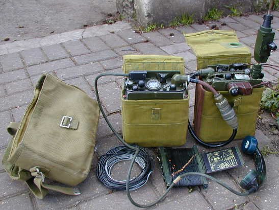

  9. chelloveck
    Back in the day when I was in the 'green machine' and we were using A510 HF radios....the aerial grounding point became the platoon urinal :eek:...it seemed to work ok. :D
    A510
    BTPost likes this.
