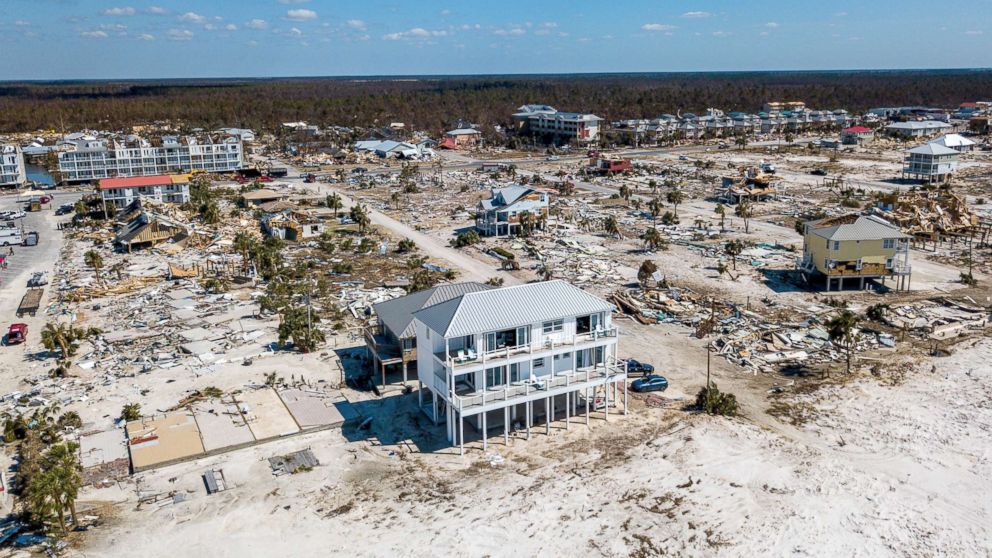

  16. sec_monkey
    wut about hurricane resistance??
    member dis house??
    it wuz the only one to survive intact
  17. SB21
    Yes sir. I do remember that one.
    A buddy of mine knows a girl that had a camper down in that area when that hurricane went thru. She figured it was going to be a total loss. She had it set up on a lot with a small deck set up to the front door. There was a house on both sides of her. Both houses were wiped out. Her camper was slid about 5 feet away from the deck. Moved it back in place and is still using it today.
    It's weird how storms react sometimes. Total destruction on some places , and barely touches other things right beside a demolished property.
