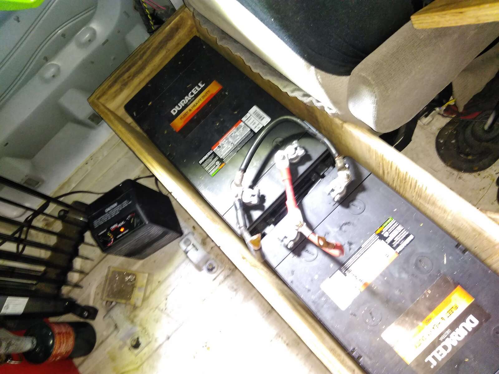

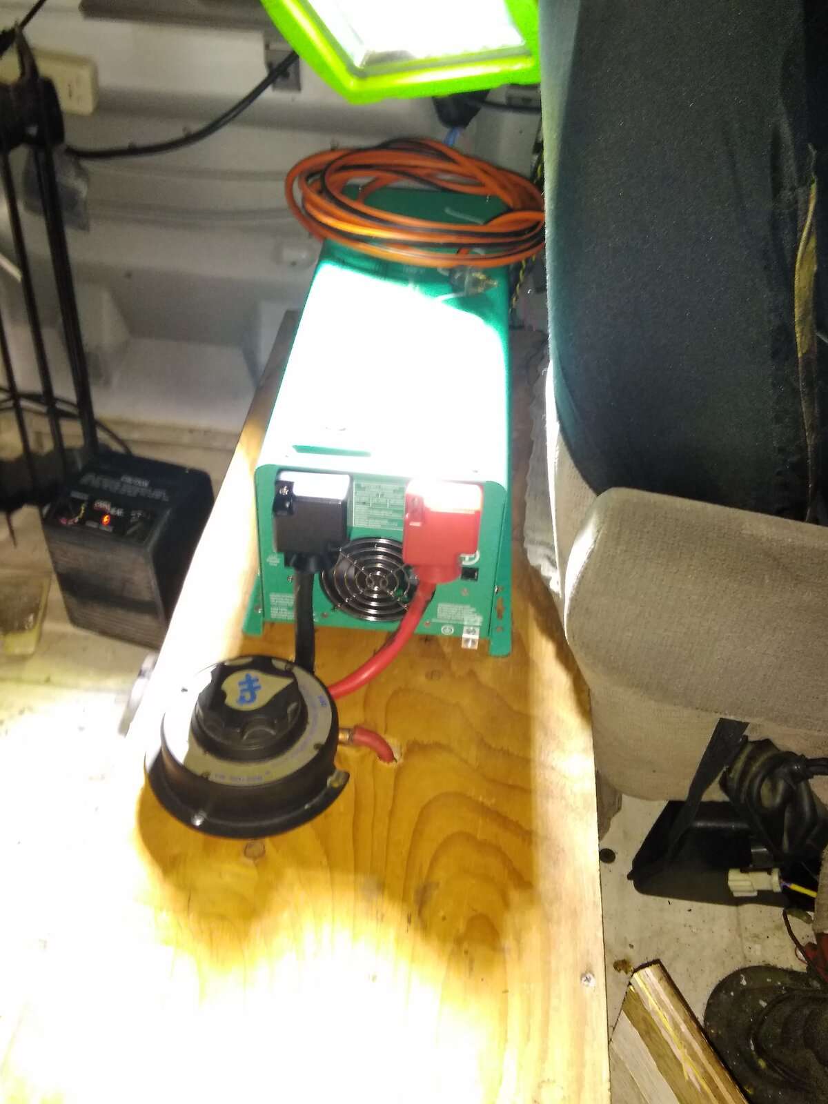

  9. kissmybrass
    kissmybrass brass monkey Site Supporter+++
    i live in a bus and i have 1 8d battery 1800w inverter/charger on it. it will run the toyo stove and laptop,modem,tv for 2-3 days.
    i made one for the van with 2 8d bats , 2500w charger inverter and the 2 van bats. that will run the renai propane and starlink dish about 2 days. right now i run them on shore power and they switch on if power goes out. 381$ elec bill has me wondering if i couldnt charge them and run a frezzer cheaper. my 2 china -100wat solar panels made 4 amps under ideal sun. its some thing and ill add them to the van eventually but i need better panels. i can run 110v air compressor, skill saw with the van off its setup.
    getting off the grid would eliminate a huge monthly bill. im getting there.
    IMG_20231227_202107. IMG_20231227_204941.
    sec_monkey and Out in the woods like this.
