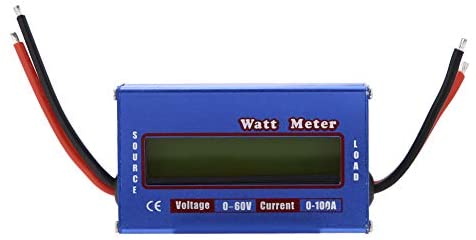

    Simple answer is no... Use a simple USB charger with your panel and it could be a 250watt panel (12volt) and it won't be too much... I use a 65watt panel for USB and small gell cell battery. A bigger panel will just maintain voltage better under cloudy conditions. The important thing is to use with a charge controller of some fashion that does the work of conversion for you. Available cheap from may suppliers. Power meters of all sorts are available from USB to RC car models. I love my little RC meter. Gives me my solar voltage, current and watts allinone small

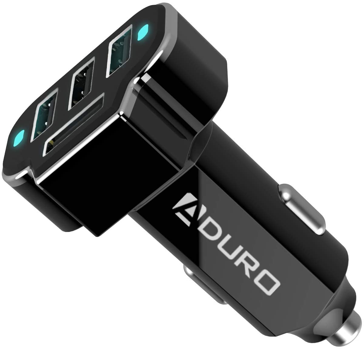

  13. 3M-TA3
    Even easier you can get adapters that plog into your car's accessory outlet/cigarette lighter. I have one with three connections and you can get higher densities,
    https://www.amazon.com/dp/B07D9WK6VT/?tag=survivalmonke-20
  14. Esar145a
    Esar145a New, but not very fresh...
    The main reason why I posted the clip on device is that it will handle 30volts just what you need for solar panel open circuit voltages. Cigarette lighter plug ins don't like much more than 16volts and can have an untimely death. FWIW
