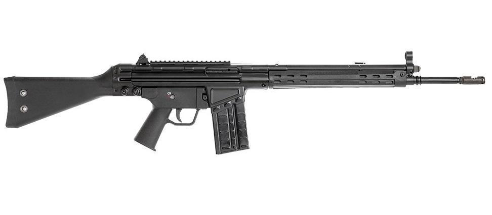

    What I like about them is you can "upgrade" mix and match with HK G-3s and really have an awesome rifle! Plus, they have the rail and the improved ejection pattern so your not throwing brass 1/2 mile to the right! Add a set of upgraded tool steel rollers to the bolt and its almost as bomb proof as the FN!
  13. HK_User
    Buyer beware, some parts do not interchange with HK 91 parts, the "battle" flipper mag release is a real biatich to install on this rifle and expensive to do, the recoil spring assembly is different and the front hand guard is not heat resistant aka will melt. After market front hand guards are excellent.
    As a Truck gun it would be great, forget the scope!
    If you can wait till they get close just use it as a club, it'll still shoot after that too.
    Be sure and wash all parts and lube properly before firing. This means the bolt and firing pin for sure as well as the bolt and guides..

    If you can adapt a HK 91 brass bumper you can easily get 3 o 5 reloads.

    I wouldn't worry about the CETME brass. You probably won't be able to find it anyway. Most will pitch it 30 feet to the right and 20 feet forward of the line. Makes nice weight for the scrap brass bucket.

    Whats the deal with fired HK brass,Is this the brass I see that looks like it was fired in a fluted chamber?
    VisuTrac and Ura-Ki like this.
    Brass fired in fluted chambers wouldn't be a big deal if it wasn't for the violence of the extraction and ejection.
    You could clean up the filthy brass and size out any deformities the fluting may cause. Not so easy to fix the case rim where the extractor yanked it so hard it'll no longer fit in a shell holder, and the big dents in the neck and shoulders from slamming into the edge of the ejection port on the way out.
    FAL drops brass on the bench right next to me....or 30 ' away, depending on the gas setting. :)
    No dents.
