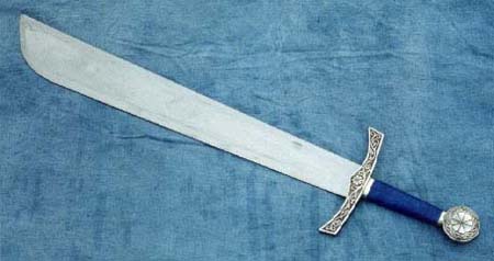

    So, I have a 22" Ontario machete. It's just right for my AO, except for one detail. I don't really like the balance point. Normally this would be a small issue, but it is the only thing I don't like about it.
    I've also been wanting a "SHTF sword", so I can put what amount to my training into practice if I need to.
    So after a couple of weeks of mulling it over, I think I have a practical solution.
    What I am thinking is that I can cut the scales off, and replace them with a layered set, of 16 gauge plate under wooden scales. That should be enough to lower the point of balance to somewhere nearer the handle, and if I cut the plates a hair long I can bend them out into a rough guard over the back of my hand, kinda like a messer.
    Now, I'm not the greatest mechanic with the most experience in these matters, but I do have a fancy new jigsaw I can much more easily rough all this out with. Am i missing anything?

    Do I read it right that you think it's blade heavy? If so, that is the way it should be. With machetes, the weight should be concentrated forward to assist with the impact while cutting, like an ax head. Sword fighting is different proposition entirely. No, a machete is not a suitable tool for fighting (works well for beheading the loser--) but your approach may improve the balance for thrust and parry, and add weight for muscle building. Doing that modification may not serve you well in an actual duel.

    I understand. But if I am going to carry the tool, i would like to improve my chances. I actually like tip heavy swords, but this is a little too extreme for my liking. And it is giving me some control issues with the cutting tasks I have been undertaking...if it brings it back to where it is on the 18" version, I will be happy. Too far in the handle, and I'll have to try something else, maybe cut the plates in half? But playing with it to get it just right is half the fun. Haha.

    Yeah, they are riveted. Drill 'em out, starting small and sneaking up on full sized drill. Go easy, you'll be into the tang steel before you know it, and there will still be rivet material in the scales. Where you'll probably hit a glitch is when you discover that the scales are also epoxied. I have a sneaking suspicion that you'll be better off building a sword from scratch.

    I think that the nearest sword type to what you seem to be indicating that you want is a Falchion.
    It has a broad blade with a somewhat pointy tip. Falchion - Wikipedia
    As with all sword configurations, this and similar designs have their trade offs that limit its usefulness for particular sword fighting styles, and other non-sword fighting utility uses. The shape seems more useful for cutting and slashing rather than thrusting style fencing.
