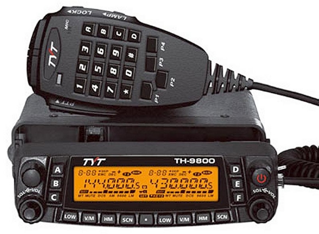

    There a few new dual and qaud band radios that look interesting
    The TYT TH 980 and Wouxun KG-UV920.

    Main Functions:
    1. Frequency Range Suitable for any Region of any Country:
    (TX / RX): 136-174MHz & 400-480MHz
    (RX) FM : 65MHz - 108MHz (100K Frequency Spacing)
    2. Band can be Set Freely: V/U U/V V/V U/U
    3. Dual Reception: Twin Band Simultaneous Reception
    4. Dual Display: Large LCD Dual Frequency Display, Two Completely Independent Operating Systems
    5. Over 999 Memory Channels: Area Scanning Management
    6. Remote-head Mounting Capacity: Multiple Installation Types, Convenient Usage
    7. Full Duplex Cross-Band: Offset Frequency & Frequency Shift Direction Programmable; UHF/VHF or VHF/UHF Cross-band Repeater Function
    8. Both Stations can Form Combined Same: Band or Different Band Repeat
    9. High Output Power (VHF: 50W / UHF: 40W)
    10. CTCSS/DCS Encode/Decode
    11. Multiple Speaker Channel Settings
    12. DTMF Hand Microphone: with Speaker, TX/RX Indicator and Volume Controller
    13. Incoming Message Display
    14. Caller ID Display
    15. DTMF Encoding and Decoding
    16. Group Calls, All Calls and Selective Calls
    17. 8 Groups Scrambler
    18. Priority Channel Scanning
    19. APO Power Management
    20. English Voice Guide
    21. Minimum Operating Voltage Settings
    22. Stun and Kill Function
    23. Single Tone Pulse Frequency: 2100Hz/1750Hz/1450Hz/1000Hz (Used when Activating Repeater Signal)
    24. Selected Three Color Backlight
    25. Reduced Noise Settings
    26. Remote Control Setting
    27. Frequency/Channel Scanning with CTCSS/DCS Detection
    28.Multiple Cooling Paths Fan
    I love Item #22 Is this thing also a StarTrek Phaser?????
