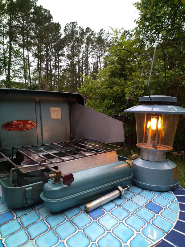

    IMG_20250224_200007. Lighting kerosene lanterns and lamps always requires preheating. Some sort of alcohol flame, or in rare cases (Coleman 206) a single fuel preheat using kerosene, or a built in preheat torch (Coleman 238B, Petromax, etc). No matter the type of preheat, it's the rest of the lighting steps that make the difference between soot and drama and soft, clean lighting.

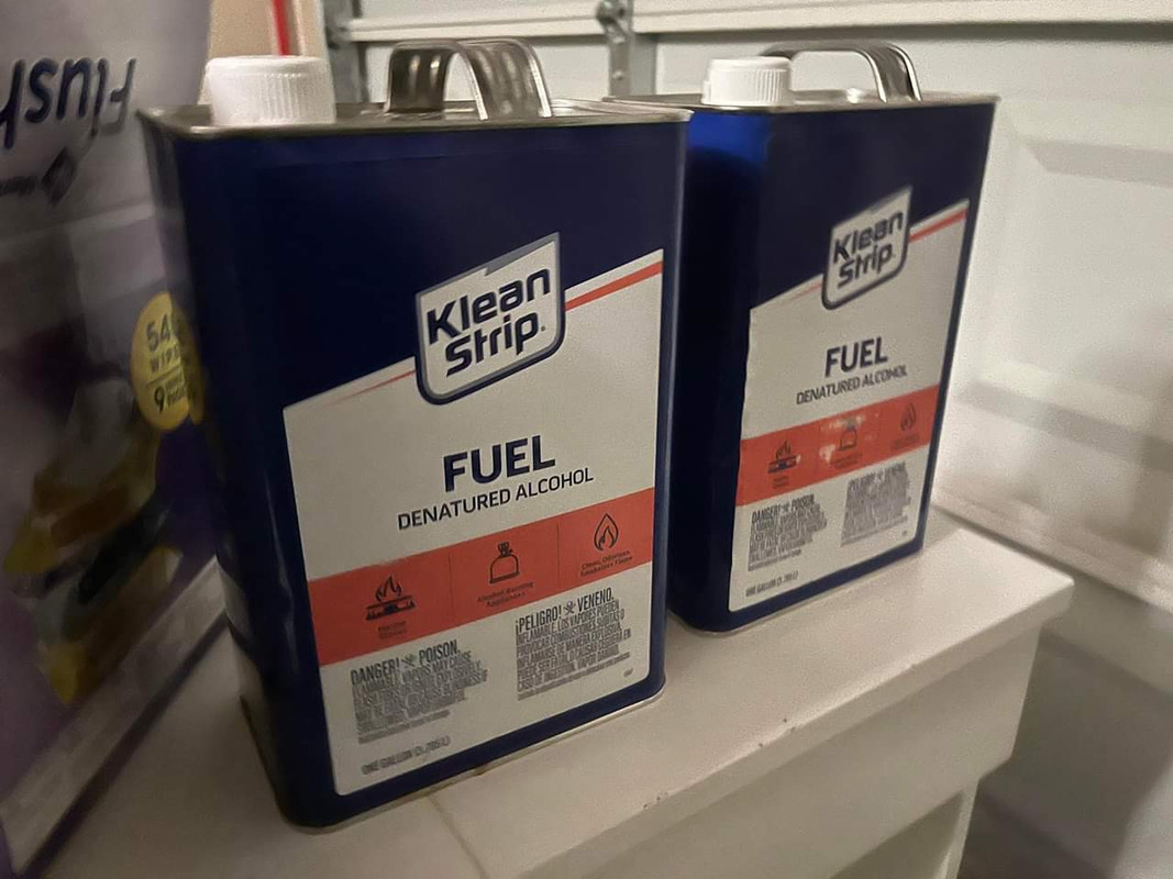

    Preheat cups can be used on white gas lamps as well, for an easier start in cold conditions or a soft start on Quick-Lite lamps that are lit indoors with pressure already in the fount and shades in place. They light quickly, since their fuel is more volatile than kerosene, but you're saved holding wood matches against the generator and not poking a fragile mantle.

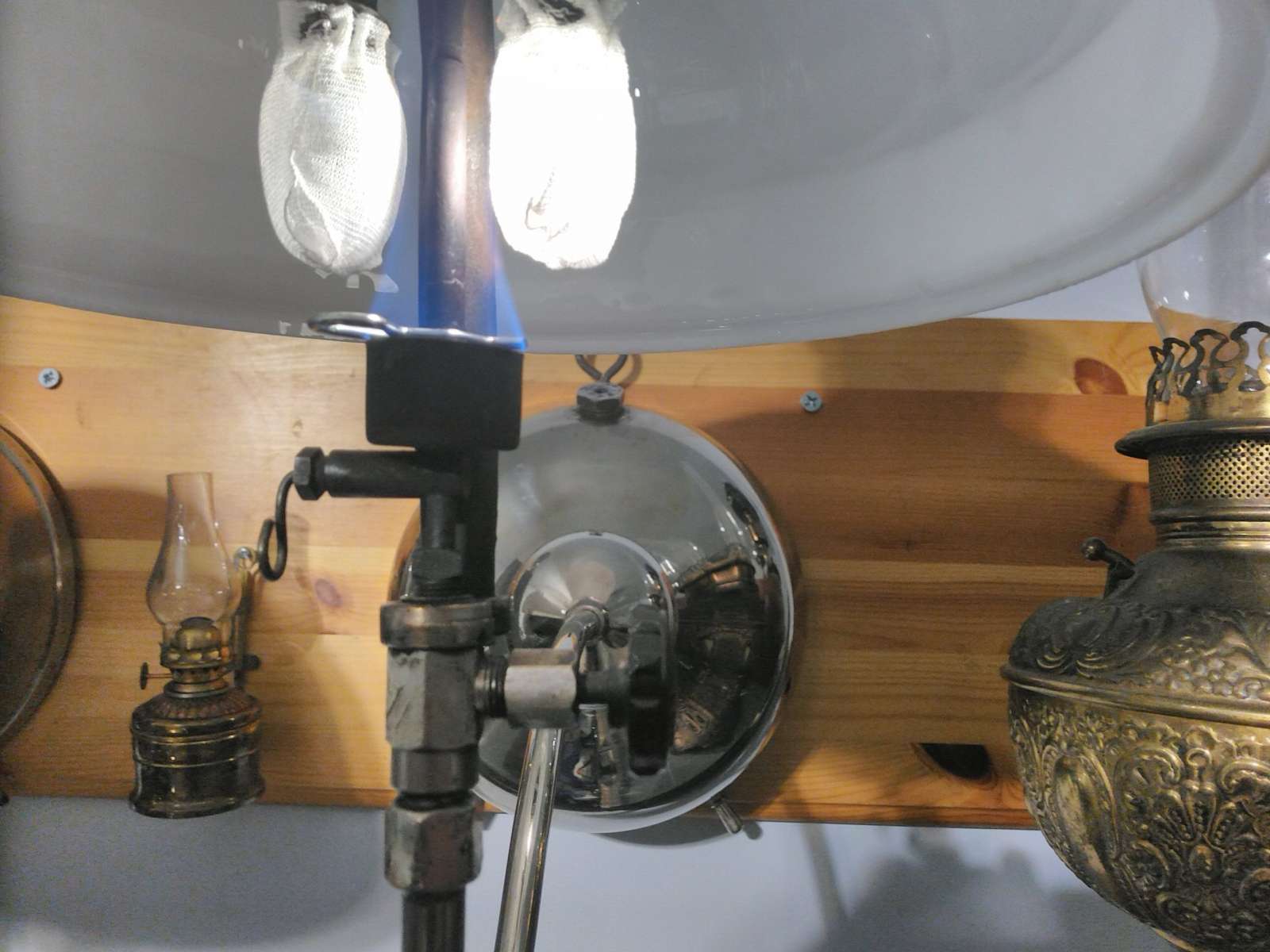

    With kerosene, the key is to start with zero pressure in the fount, valve open (to allow fuel to drain back into tank) and cleaning lever down. This all allows heating of the generator without any fuel expanding and leaking out of the tip, causing premature flames and soot.
    When the first preheat cup of denatured alcohol is almost burned out, close the fuel valve and add a slight amount of pressure. I use 5 PSI or three pumps with a hand pump. Then, before the preheat cup flame burns out, open the fuel valve.
    This should allow time for fuel to fill the generator, vaporize, and light the mantles at a low glow. If you miss the timing and the preheat flame burns out, close the valve, add a bit more alcohol to the preheat cup, light it off, and open the valve again.

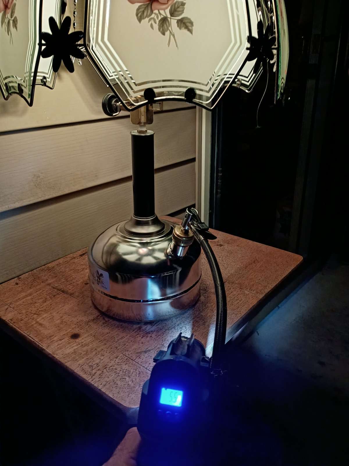

    Once you have a nice soft start and both mantles are burning you can add more pressure until they burn bright.
    Once you've mastered the timing you should be able to light your kerosene lamps indoors with no dramatic show of flames or soot and no kerosene odors.
    You may still want to shut them down on the porch or in the fireplace, to keep kerosene smells to a minimum. I've found that simply leaving the fuel valve open and releasing the pressure in the fount (safe on kerosene lamps, not on white gas) and allowing fuel to drain and the final vapors to burn away in the mantles creates little to no odor and sets the lamp up for the next use.

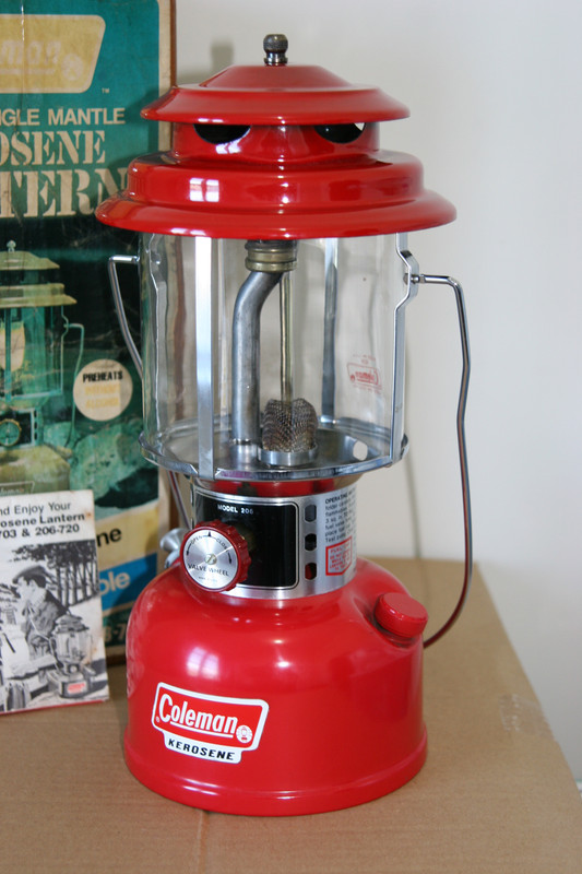

    For Monkeys living in foreign lands where denatured alcohol (methylated spirits) isn't readily available (Vietnam, South Africa, California) there is a solution. The Coleman 206 was an export only kerosene lantern model that was designed to use the fuel in the tank as the preheat fuel.

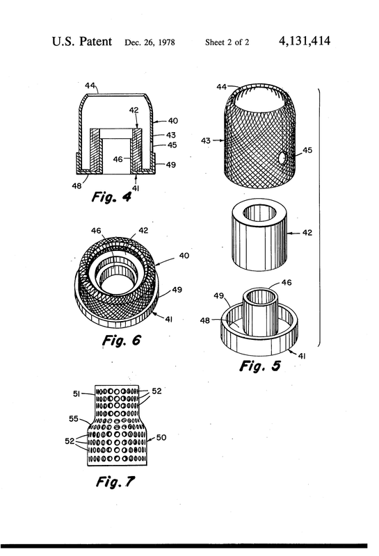

    It used a patented screen and cup design that appears complicated.
    In my quest for a single battlefield fuel I made my own. Mine didn't look as high tech as the patent drawings, but it worked fine. Tiki torch wick in the cup and a stainless tea strainer screen with a lighting hole cut into it with a small grinder bit. You could just as easily poke a hole in the screen with a pointed stick, or run a small (Zippo Lighter) wick over the side of the cup and wet it with kerosene to allow easier lighting of the kerosene in the main preheat cup. A simple eye dropper or just a length of tubing (plastic straw) inserted into the fuel tank, and sealed with your thumb as you move fuel to the preheat cup is the only other accessory needed.
    My 206ish preheat cup is sitting above my normal alcohol preheat cup on the generator.
    The screen seems to be the key, directing the flame straight up the generator with surprisingly little smoke or soot.
