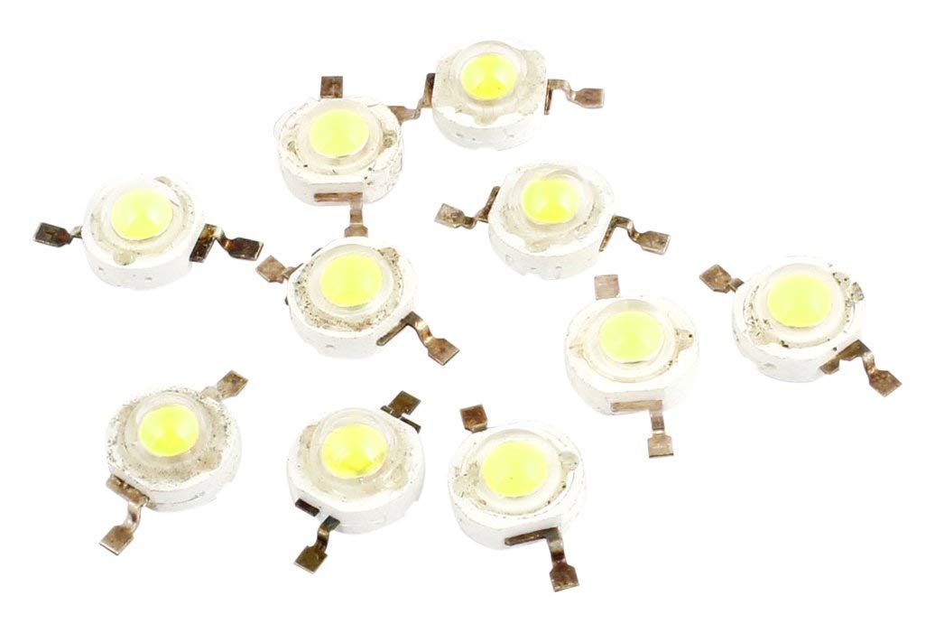

Leds for replacing the bad OEM LEDS in a Lantern.

  3. HK_User

  4. techsar
    Do those have current limiting built in?
    sec_monkey likes this.
  5. sec_monkey
    @techsar [dunno] but seriously doubt it
    ya normally need a gud driver/voltage regulator to run em properly
    Cruisin Sloth and techsar like this.
  6. techsar
    Yup...that might be why they're so bright :eek:
  7. sec_monkey
    they aint got a visible heatsink either
    high power LEDs usually require a gud heatsink plus regulated power at the exact proper voltage that is needed to drive that particular LED
    not all LEDs are the same
    techsar likes this.
  8. HK_User
    • Product name : 1W LED emitter; DC forward voltage : 3V;DC forward current : 300-350ma
