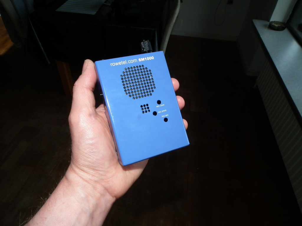

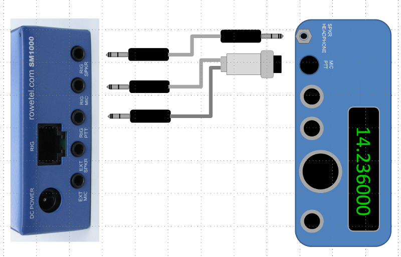

    Want LOP comms? (Legal encryption, or nearly so)
    The Rowetel SM-1000
    SM1000 | Rowetel
    Digitizes the voice. Requires two units.
    Perfectly legal owing to open source application (FreeDV)
    BenP likes this.
