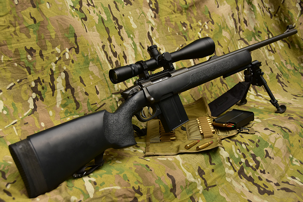

    ..... yesterday was a picture taking day so I snapped one of the rifle I had on the bench. This is my old Stery SSG... it dates to the late 70s or early 80s I believe. I bought it second hand in 1986. It was a factory package that included the rifle, spare magazine and Kahles ZF69 scope in serialised mounts. Sometime in the 80s they added a rail to the forend, this pre-dates that.
    Over the years it has evolved somewhat from the plain (but very functional bang stick) green rifle it was then. The stock was badly damaged in an "unfortunate incident" and replaced @1993 with the one seen here made by McMillian. A couple of years ago I got the Leupold Mk4 6.5-20x and then the Steyr Picatinny conversion rail to mount it. Finally a company called Styria Arms in Austria offered a replacement trigger guard and magazine well that was i) metal (original was composite and a weakness) and ii) allowed the use of Accuracy International Magazines. I had it away with me last year and, using the load I developed for my Sako .308 hunting rifle, will still dump each projectile into a single ragged hole at 100yds. I am heading west next winter where the ranges are longer and the ground flat.....

    That vintage of SSG's are some of the best overall IMHO.
    Just wondering but why did you replace the original glass? The trigger guard upgrade was a good idea. Great looking rifle. I do not own one, but would like to!

    My SSG is about the same era as yours, very nice rifles even today! There was a time when those SSG's were about the most accurate .308 available any where, they had some super secret mojo going on with their barrels, and no one could match them for a very long time!
    You got a keeper there, don't let it go for any reason!

    ... the original glass (the ZF69) is a straight 6x (till 1998 it was also the glass on the issue Australian Army sniper rifle). It is a beautiful clear optic and I can still slide it on there as it resides in the QD rings ready. 6.5-20 just gives me much more range (not distance but use) than the straight 6x and the adjustments on the Leupold are more precise. 20x does make shooting little groups that much easier !!
    ....it's going nowhere at all mate ! Funny, when it arrived I took it to my makeshift range (using the hood of a mate's old 4x4 as a bench) and shot a group with some Federal 150gn factory hunting ammunition I had laying around. First three shots went into a single hole. I was impressed and (despite it needing a good cleaning @1992 due to some copper fouling mid barrel) it continues to impress today. My Godson got the long range rifle bug from playing with this last year. He has not decided what he will build up year (he hunts with a Remington 700 in .270 now) but it will be something nice I am sure !!!

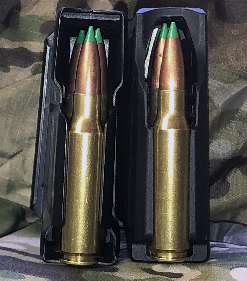

    Well....just finished a little project on this that I have "been meaning to do" for ages. A little ago a local (not so local to me but here in Aus) had MagPul AI compatible 7.62 10 round magazines on sale for around $65 (they are $79 normally) so I grabbed one to see if it would work in this as the Styria made bottom metal is quite precise and I previously found that the Ruger GSR magazines, while a copy of the AI and supposedly interchangeable, didn't work. I was a bit disappointed when this arrived and it would not feed at all.
    Everything was right except the lips were holding the case a little lower in the magazine than I saw with factory AI versions and as such the bolt was unable to make contact with the bottom of the rim to strip the round from the magazine and feed. So I threw it in the back of the safe to think about or sell etc. (returning it would have cost me $15 or something stupid in postage and "restocking fees", this dealer is a c#nt but does have gear no one else does).
    Laying in bed one night months ago I had a bright idea (other than the one involving Pippa Middleon and a can of whipped cream) that I finally got around to acting on today. I measured the spread of the lips on the AI magazine and that of the MagPul version and also the height the case sat when loaded (the later using the amount of primer exposed). The AI feed lips are far shorter than than MagPul versions and sat around 1mm further apart +/- along the length.
    So I set to with a sharp file, calipers and some wet and dry. I took the AI lips out just less than 1mm (.5mm off each side +/-) and also added some taper out at the front (effectively shortening the length of the lips in contact with the case.* File a little, test fit and file a little more. About 15mins work start to finish, and now they are feeding 100%
    Post Christmas I will order a couple more. AI Magazines are great but when I CAN find them here they round out around $150Aussie vs $80 for the MagPul Paying full price).* MDT also make a reasonably priced 10 round compatible magazine but for now I will stick with the MagPul.
  13. Andy the Aussie
    AI on the left MagPul on the right...
