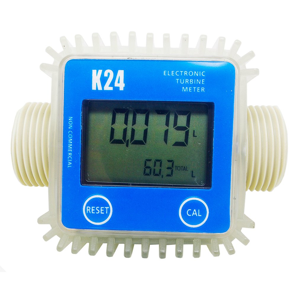

    Orderd a little Diesel Fuel Flow Meter from Amazon, today... It runs on a couple of AA Cells, and is said to be +/- 1% on Total Fuel thru, and Fuel per minute... We will see... I plan on putting it InLine with the Fuel Distribution Header that will feed the three Diesel Gensets in the Powerhouse up at the New Place... It also has some kind of Digital Output interface, so maybe I can build a Powerhouse Controller that monitors the. Gensets and logs their operational Data... This will give me a chance at finding out the Fuel per Kw Generated on each of the Gensets, as well as Gal per hour for each Genset at a specific load...

    Amazon.com: Diesel Fuel Flow Meter

    This one ? [​IMG]
