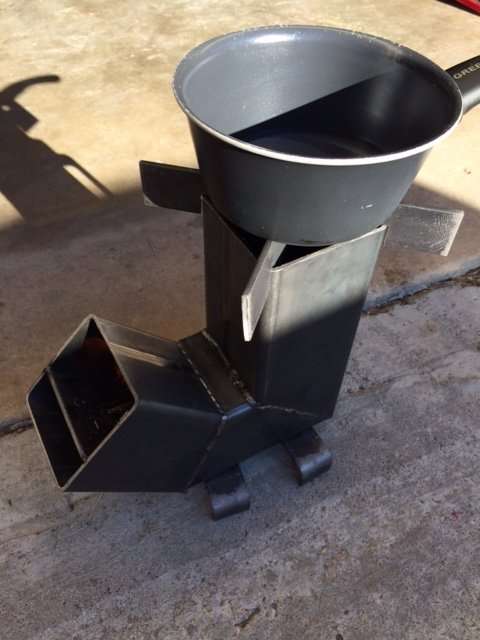

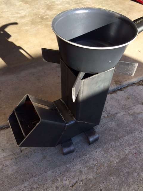

    My son made a rocket stove in metal shop. The teacher has the kids draw up their own design and plans, figure the materials and then they start constructing.

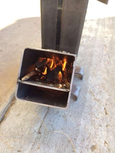

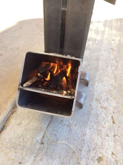

    The feet are detachable and so the grate. On the back of the stove is a handle which I didn't get a picture of. You place twigs, leaves and branches in the upper part of the arm and the bottom is for air. It works great. It is heavy because it is solid metal and does get hot but this is a great stove that can be used camping.
    I am a proud Mom. He did great and the teacher really liked that my son chose to make something unique.

    Just a little concerned with angled feed maybe allowing a lot of heat singe skin and hair of those feeding it (vice horizontal feed) but otherwise design is pretty awesome. have you or he boiled water on it?
  4. Motomom34
    The feed was an issue and he got to use his torch, which made him happy. We boiled water and the pan did not get too hot. I think because the vertical is so high, burning will not be such an issue.

    Interesting twist! Looks really tough, and I like the heavy steel, Keeps warpage down, and retains the heat good.
    Maybe a second prototype with out the angle burner at the bottom, but keep the devider, should generate more air speed and flow. Just a thought!
    Nice work, and the welds look pretty good, @Tully Mars will be impressed, I am!!!

    Looks like it would be self feeding which is a drawback on mine. You have to keep pushing each stick until it is consumed. They do work well. Mine is a metal and concrete design. His appears much more durable.

    Thank you all for the comments. With firing mine up yesterday, he was able to figure some adjustments that are needed. He will be making one for his brother that will be slightly different.
    This one is Mom proof. No way can I break this.

    The MkII version might include a horizontal feed tube that was separate and could be nested in the chimney tube.
    A small diameter cross-bolt with a Mickey nut or binder screw could hold the pieces together, both in assembly and in nested mode, and the (drilled) slats and feet could also be nested and held in the feed tube on the same bolt.
    That would make a compact rectangular package for easy packing, and it could be bagged up easily to prevent soot from migrating all over a backpack or BOB.

    That right there is a great idea, a sliding feeder that can be adjusted for burn intensity and output! Take two pices of square stock, a short piece welded to the chiming section with the longer one able to slide in and out. That could really make this thing rock, a slow burn for general heating, and a faster burn for heavier cooking needs, and like you point out, could also allow it to break down to a smaller package for transport or storage! I like it!
