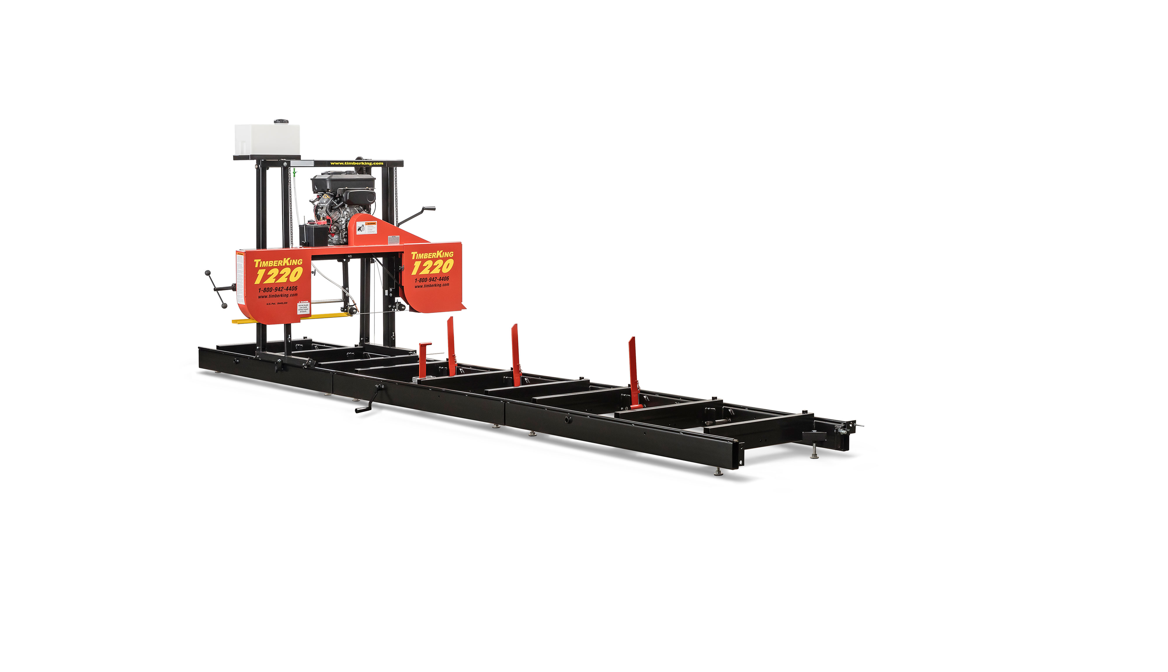

    I have been given serious thought to a sawmill as I have a lot of logs and so much firewood I cannot store anymore. Plus, I have many more trees to cut this Spring/Summer.
    So, I am looking for recommendations concerning sawmills: Make, models, nice to have, experiences, what you would do differently and info you can pass a newbie.
    I have a new Kubota tracker and forks to move the logs and a flexible budget say around $10,000.
    I do NOT wish to jump in with both feet and spend $35K but want a good functioning unit that is effective in time and cost. I tried those Alaska mills and they take too much time to make a good product and its very easy to make a mistake, making the product inaccurate.
    Finally, no I will not be doing this professionally. The wood would be for myself and/or neighbors and friends.

  6. CraftyMofo
    CraftyMofo Monkey+++
    Timber King
    Bandit99 likes this.
  7. sec_monkey
    .. .. looks gud .. ..
    dey aint got em in stock tho :(
    .. .. dey cant even quote a real price fer it .. ..
    .. .. if yer lucky ya might get it in late 2023 or 2024 or 2025 .. .. [dunno] [dunno]

  11. CraftyMofo
    You need to find them used. They’re out there. Look for a B-20.
  12. Bandit99
    @Cruisin Sloth "I went with woodmizer LT15 and an LT 40 Hyd on wheels..."
    Yes, I have been looking at the LT15 for ~$10K and parts availablity would be a huge reason to purchase Woodmizer as they are the most popular sawmill. Thinking real hard on trailer also as really like the idea to be able to move so easy but then it is harder to get logs onto deck so... What size motor do you have as it comes with 19HP (standard) or 25HP (option)?
    Looking at the photos, the TimberKing seems like a brute! But, I can't wait until 2023. I've also been looking at Hud-son and Norwood.
    @CraftyMofo "You need to find them used. They’re out there. Look for a B-20."
    Up this way (North Idaho), you will very seldom see sawmills for sell. They are like tractors as soon as someone decides to sell it's gone or it is sold to family member or friend but I will take your advice and look in the local papers. I was looking at the 1220CRZ for $13,200 (that's with trailer) but I don't think they make the B-20 anymore. Besides, they are taking orders for 2023 and 2024 and I can't wait that long. Do you have personal experience with TimberKing?
