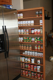

    Nice use of space, but wrong casters used. (Should have been inline, not swivel) and it needs a back panel. Even Masonite 1/8" or 1/4" would do. The BACKER is what keeps it square, and there is no need to get to both sides.
    Add a pair of drawer guides to the wall side, and it will slide a lot smoother, (like a desk drawer), and will hold it upright when loading and unloading.

    @kellory
    Like many ideas....additional eyes and brains will see ways of improving the basic concept.

  4. kellory
    Nice idea, and simple to do. Plate steel backers, and a hanging rail.
    Edit: but why leave a weak centerline? Add a porthole to the backer, build bigger than the window, and slid completely across from one side.(and remember bullets go through walls. Build that bookcase to just above floor height.)

  5. Motomom34
    Original construction looks like the bottom frame on my futon. I do question if it would mar the door on the fridge.

  6. chelloveck
    chelloveck **BANNED**
    some refrigerators can be hung from either side.
    Seepalaces likes this.
  7. kellory
    Not that fridge. The pictured one is double doors. But yes, most fridge doors can be reversed.

  8. Motomom34
    My thought is people with kids would run the risk of the kid banging the door against it. It is a great idea but having a line down the fridge door would drive me insane. Maybe you can use an old hose for a door stopper. Or leave space to protect the door.

  9. kellory
    It would, if you do not allow enough room for the door to pivot. Easiest way to make sure it clears, is to stop the front edge, just behind the door, even with the body of the fridge.

  10. kellory
    They should not be open at the same time. The door would be in the way of getting to the shelf. ( if it were behind the door). If it were on the handle side ( recommended) it could have very little effect on the door.

  11. ghrit
    Some fridge door hinges will allow the box to fit flush with a wall and not scrape anything when opening the door (like mine.) Uv cuss, you need to know that before starting the project, but if your box is fit with that type hinge, it's the best of both worlds.

  12. Motomom34
    You are correct. I opened both doors on my fridge and they do stay flush.
