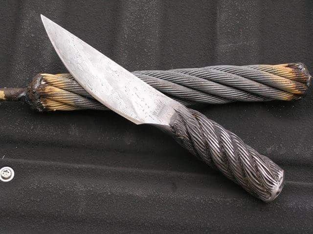

    I'm not a blade maker, but saw this and thought of the possibilities for others here who have the equipment, tools, and metalworking skills
    Sharp edge and grip made from the same material.....it would also work for spear heads too with some minor modifications, I would guess.
    Via:Whiskey & Grit : Photo

    Getting that cable to weld together would be a chore, to say the least!! Wow!! Nice blade!

    Have to wield both ends heat untwist a little ad flux heat back up re twist and heat and hammer

    Actually it's not too bad if you can keep the end tightly wrapped. I haven't watch the video but I've cut a lot of cable on drilling rigs. Keep it as tightly wrapped as you can and use your heat source (a torch in my case) to fuse the ends.You want to melt or fuse the strands but not overly burn the steel. Basically like using a lighter on the ends of a piece of paracord.
