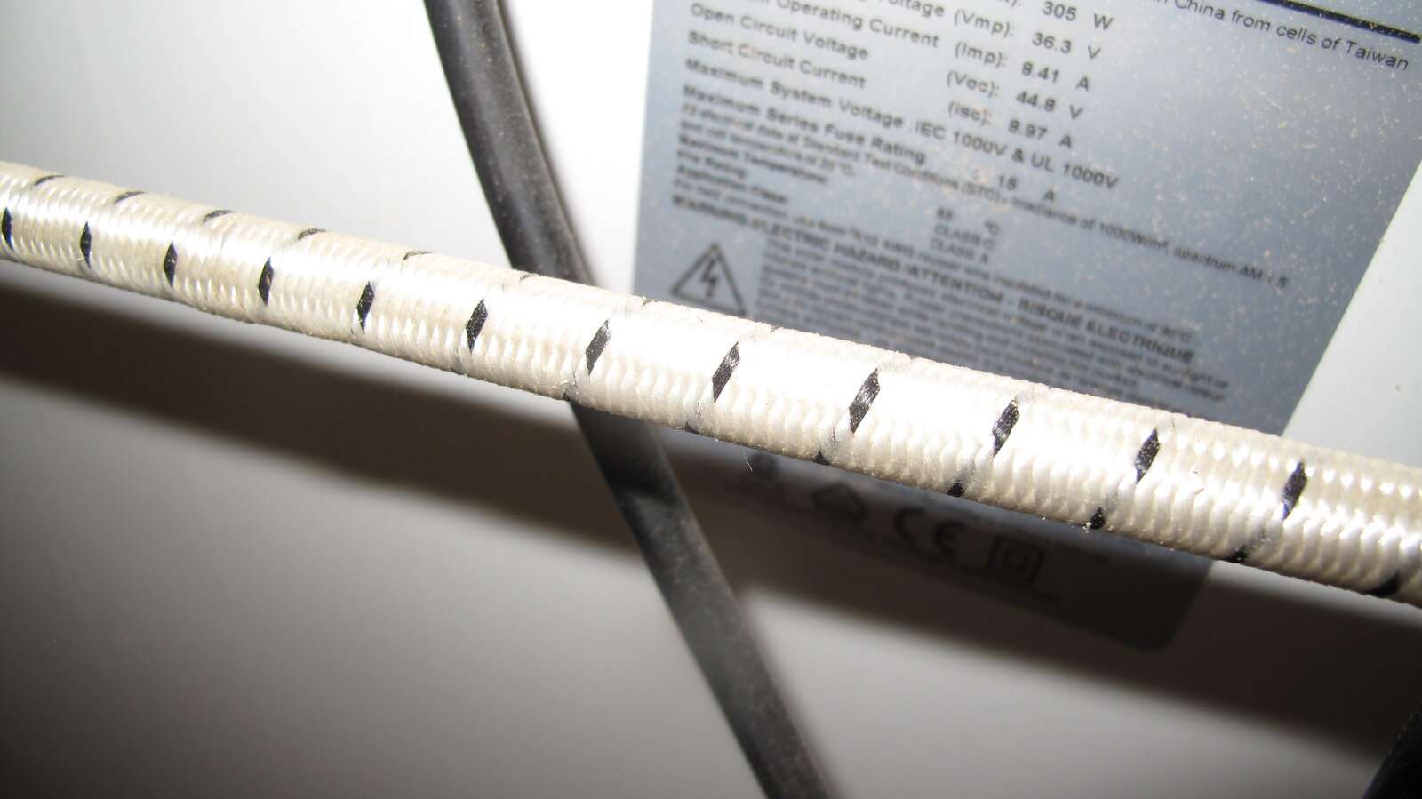

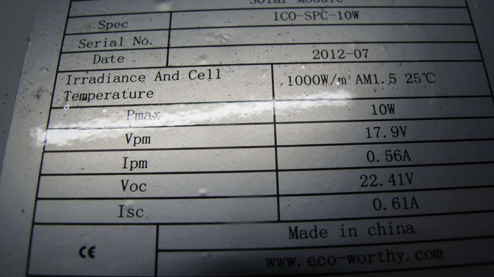

    To check ANY solar panel ,all is needed is a DVM on a 10 amp scale (if panel can put out more than 10 amps , internal might blow)..put DVM in series with output panel wires , (makes no difference on the polarity ) hook up all connections with panel away from sun and not making power. I use MC4 modified ends for this , has no locks on the ends i made , ground them off ,and just 10 gauge wire tinned pokes out is where my DVM alligator clamps to.
    now face the panel to the sun as it hits right at the sun amps should be almost to the ISC spec on the sticker . Sloth
    Edit add !!
    Make no connections or break connections when in full sun !!
    Sparks will happen and the MC4s could be damaged!!
    I turn panel away and shade it ,alligator clamp is removed from Mc4 and now the short is broken , now when seporating the MC4 no chance of a spark/arc welding !!
    On voltage readings they can be in sun , but here were seeing if amps can be made ..
    S

  11. Cruisin Sloth
    Explain this testing for me plz , I know your using a Amp clamp , DC one I hope , most are AC .
    Clamp on are close if they are tested and zeroed in .The Craftsman one is nice but is off by 5% some days , the others are from my oscilloscope that reads in Picos .
    Whats the battery for ?Load ? ISA is shorted , max load . If good battery is fully charged and your testing a low voltage panel 60 cell type thats rated at 18-22 VDC whats the amps going to show on a battery at 13Vdc (charged ) ??
    This is where im having a trouble to understand to find out if the max out can be obtained ?
