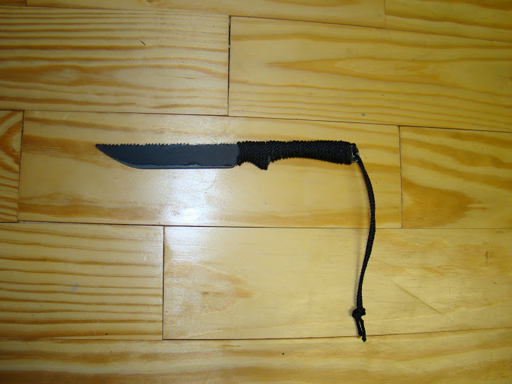

    Clever, but your thumb is in contact with the serrated edge!
    Needs to reduce the serrated area.

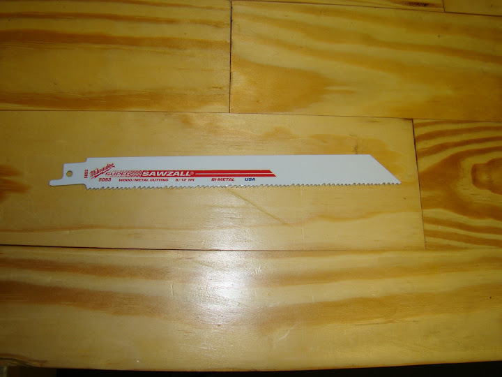

    Ok, here's what I've got. I used a reciprocating saw blade instead of a hacksaw blade. These blades are much thicker and stiffer than hacksaw blades. Out of my used blades I also chose Milwaukee over the dewalt blades. Again, the Milwaukee blades were thicker and stiffer than the dewalt blades I have.
    I used a bench grinder and dremel tool to shape it. If you haven't tried the quick detachable wheels for your dremel you really need to, I probably would have broken off at least 3 maybe more of the little bolts that thread into the standard mandrel. With the quick attachment I had no problems whatsoever.
    Using the reciprocating saw blades the thumb placement area cover on the serated part that FS brought up above was even more important so I wrapped the handle with trot line.
    I used an old knife I keep in the basement for misc cutting to get the shape.
    Here it is, didn't turn out to bad for a just under an hours work including paint and wrap.
    what I started with
    Pretty much done, yeah I know I need to repaint it with something else.

    Very nice! Have to give that a go on a future day off. Sounds like a good project once winter sets in.

    You're right about that. I'd think all he'd have to do is use that sander to grind the teeth off in an area where you'd rest your thumb.

    Used a blade from a keyhole saw(I think. It was lying around, so not sure). I was going to put wooden scales on it but figured that para-cord would be more helpful in a survival sit.
    Mostly done on a bench grinder. Started with a belt sander, but found the bench grinder easier to manage.
    Having some trouble getting it really sharp. Any suggestions are welcome.
