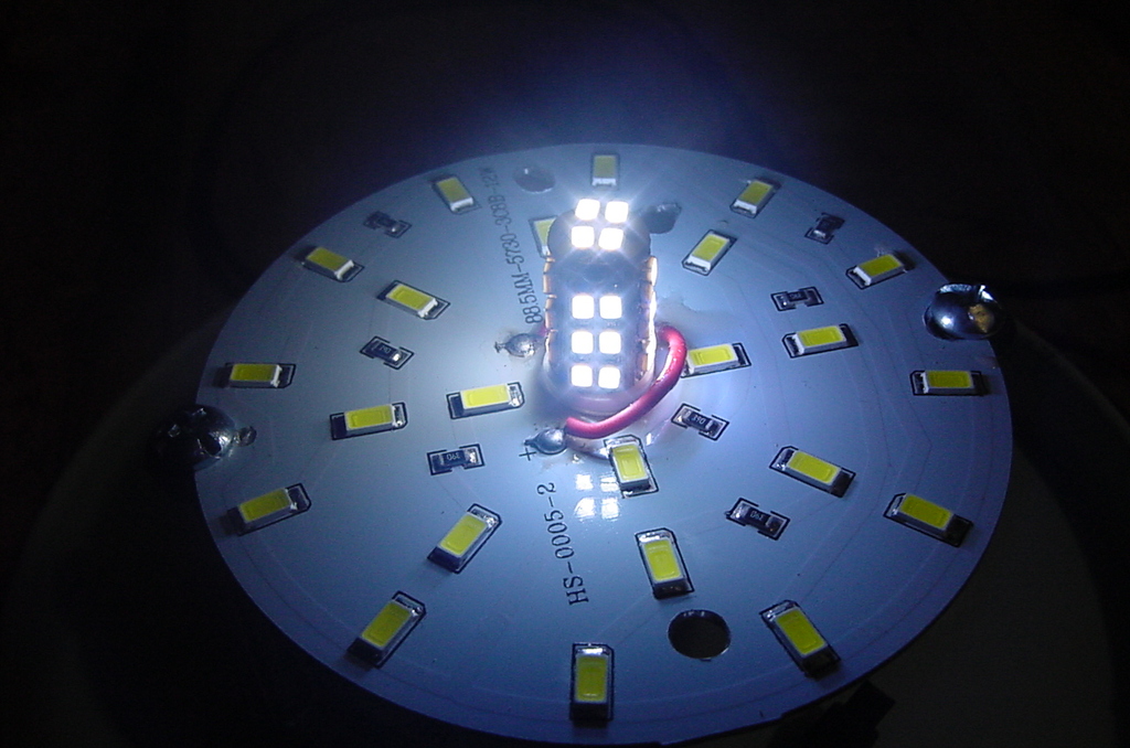

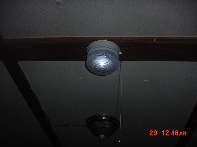

    Hello new old guy here, I build most of my solar accessory's this is one of them
    I have looked and I can't find a place that sells 12 volt light fixtures for the home.

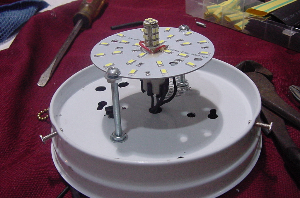

    The 12 volt LED light bulbs are to big for standard fixtures so I took the LED board out and installed it I my own fixture.
    The bulb in the center is a small led for automotive use it's very dim (194 replacement bulb)

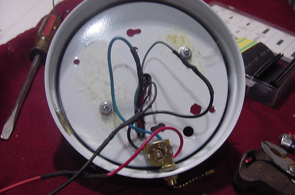

    A three way switch was used so ether the night light or the bright light can be used independently

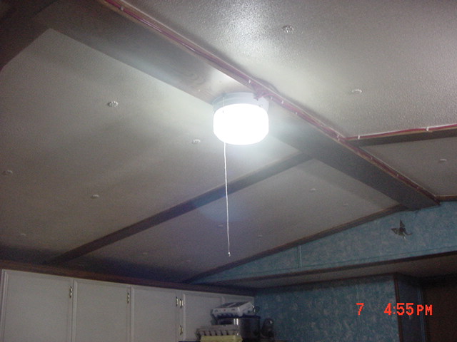

    yea, I found the same thing, Where as incandescent pulls 60 - 70 watts this light only pulls about 9 watts.
    They call this a 12 watt bulb but doesn't pull that much. So yea about 5 to 1

    Yes that's a good idea. It's just that I wanted a light fixture that looked like a regular light like what I'm use to.
    And even using all new stuff only have about $17 in this light (including the fixture)
