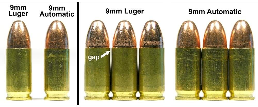

    An article on a seemingly not-so-critical issue, but an interesting observation nonetheless.
    I have experienced the "nosedive" in certain handguns, but attributed it to either the bullet or ramp.
    LINK -> The 9mm Automatic: A Better 9mm Cartridge | Shooting Times
    Insightful comments welcomed...

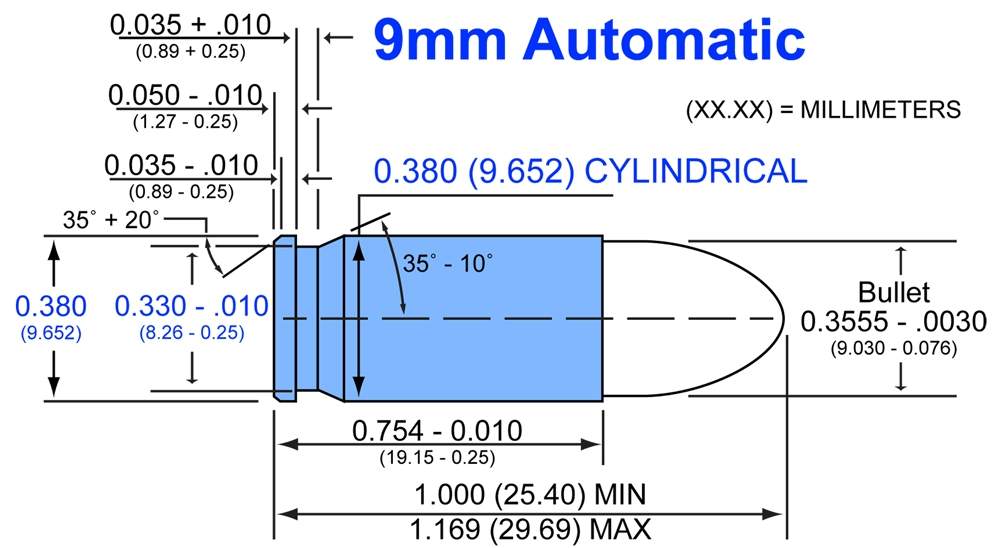

  11. Dark Jester
    Dark Jester Quester...
    9mm-Auto comparison. 9mm-Auto.
  12. Brokor
    Thanks. I meant his particular loads since people reload and the OAL does vary. I once reloaded HP rounds and after seating they were a tad shorter, which caused feed problems! I should have been more specific, my bad.
  13. Dark Jester
    No problem. Disregard if you already have the specs.
