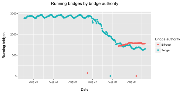

    After ten years of volunteer maintenance of Tonga, Tor's bridge Authority—a piece of critical infrastructure within the Tor network—our colleague and friend, Lucky Green, a long time cypherpunk, and free speech and privacy advocate, has decided to step down from this role. Tonga's cryptographic keys will be destroyed this week. We are incredibly thankful to Lucky for all his support and selfless labour in maintaining a key component of our censorship circumvention efforts, grateful for the years we have spent working with him, and very sorry to see him go.
    The Bridge Authority is a simple but essential piece of the Tor Network. Unlike the other directory authorities, the Bridge Authority does not get a vote in Tor's consensus protocol. Instead, it serves to aggregate relay descriptors which Tor Bridges send to it, checking their cryptographic validity and testing that the Bridges' ORPorts within these descriptors are reachable. It then sends these descriptors to BridgeDB, which does all the deduplication, cryptographic signature verification (again), stability calculations, pluggable transport argument validation, assignment into the hashring of each Bridge distribution mechanism, and finally distributing the Bridges to Tor clients.
    This transition does not affect Tor users, regardless of whether or not Bridges are used to connect to the Tor network. However, it is extremely important that relay operators running Bridges upgrade to tor-0.2.8.7 or tor-0.2.9.2.-alpha, which contains a patch to replace Tonga with the new Bridge Authority. Bridges which do not upgrade will cease to be distributed to new clients; however, clients which have connected to your Bridge previously will still be able to connect (at least until your Bridge's IP address, port, or fingerprint changes).
