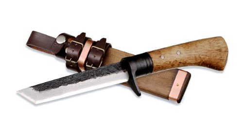

    "Kanetsune 10.25" Encyou Knife Product Info
    Devoted outdoors enthusiasts will have a great time with the Kanetsune Encyou Knife. This Knife from the knife experts at Kanestune measures 10 1/4" overall with a 5 5/8" 15 layer Damascus blue steel blade and a round design oak handle with black finish steel finger guard. Don't venture outside without the Kanetsune Encyou Sword.
    Kanetsune KB247: Encyou Knife
    Features of Kanetsune Encyou Knife:
    • 10 1/4" overall
    • 5 5/8" 15 layer Damascus blue steel blade
    • Round design oak handle with black finish steel finger guard
    • Magnolia wood sheath with brown leather buckle style closure and copper finish metal trim"

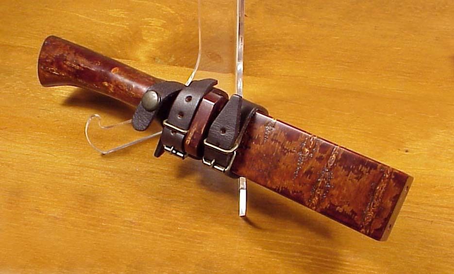

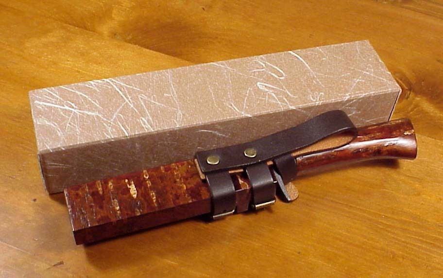

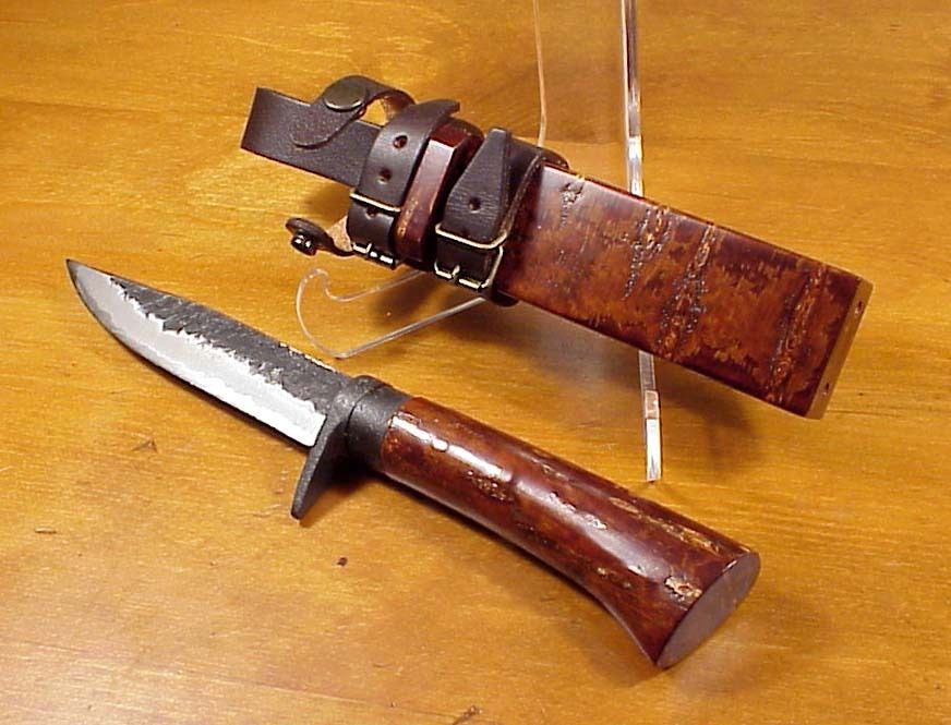

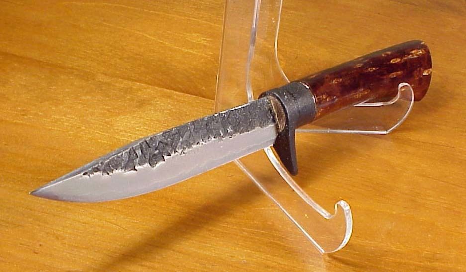

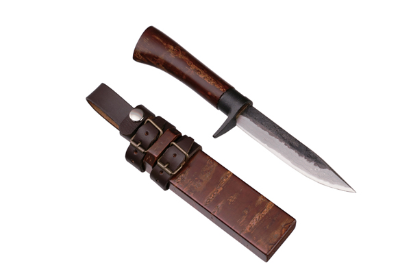

    When received it proved to be a mis-mash of sourced components. None of them really bad just a bit of a surprise for a Japanese Layer Forged bladed knife with sheath.
    The knife is light weight with a 5.6" blade, a stout white Oak handle and a wood sheath of Magnolia and a leather frog with steel buckles.
    The pins on the oak handle were not penned properly and as finished they were above the wood and very sharp edged. The two woods of the handle and the sheath were so far off matching in color that you would have thought this was an "ebay" find and not a Japanese production knife. The handle being white Oak was just that, near white to cream in color. The Sheath was well made but did not have a drain hole so you could expect to have a sheath full of water if out in a storm. the Leather frog is well made but again it is yet a third color of brown and did not set well with the GREEN tint of the brown sheath and the white Oak handle.
    A sharp new file did great work on the handle pins and a bit of work on the steel blade guard and wooden handle joint, also a sharp edge on the oak at this point.
    A small rasp was used to remove the factory plastic finish on the knife handle, this was used as a way to roughen the wood to have a bit of a grip to hold on to after the final application of BLO.
    All parts were pulled apart, checked for fit and then the task of matching up the colors was tackled.
    Oak, as a stained product, seldom accepts colors of stain using an oil base. So a water base color must be used. The Oak wood must be sanded to remove the factory finish and then roughed up a bit with rasp for a decent grip.
    A good color picked to match each item was determined to be of a walnut hue. This worked out pretty well and looks more natural than the original colors.
    Not having any water based stains or paints I brewed up some Espresso from a French roast Coffee of a Turkish grind. The handle was placed in this hot liquid and the stain was brushed on and dried a number of times. The hot coffee opened up the grain of the wood and allowed the stain to set.
    The same Espresso wash stain was applied to the sheath and the leather frog, yes even the leather needed a bit of work and the inside unfinished section received a bit of coffee stain. Each item was compared with the other and a final color was found to be as best as it was going to be.
    Still the colors did not match, the Green Sheath with brown tints, and the white Oak handle were off a bit. But now I could use a bit of "rust" coloring to bring all the colors to match. Using some old enamel hobby rust red paint and kerosene I applied a wash of the red to each item. soon the colors came together and I allowed as how it was a big improvement and one that would need to be cured a while.
    After curing and drying I then applied several very light coatings of BLO (boiled linseed oil) on the wood components and will need to do a few more coatings and polishing of these stained parts. I then used Ospho to bring out the grain in the layer forged blade..
    The completed project pictures below say the rest.

    Posted today to answer a few others' questions on the blade material and quality
    These two pictures to better display the layered steel.
    One of the spine and the other of the blade.
    Enjoy
    As a knife this is pretty decent it would have been a lot better had the knife been checked and detailed for sharp edges and spikes before shipping. Maybe I received the only knife from that Monday's production which was not inspected.
    Yes I would buy one again, but if you purchase one expect to check it out as soon as you open the box.

    Below is the stock photo and the description.
    Kanetsune Knives 215 Kage Damascus Fixed Blade Knife with Oak Wood Handles
    by Kanetsune
    Be the first to review this item
    List Price: $260.78
    Price: $145.35 & FREE Shipping
    You Save: $115.43 (44%)
    Kage, 5.32 in.
    • 15 Layer Damascus, Oak Handle, Wood Sheath

    As promised, the new purchase is at the top. The knife handle is not matched very well with the sheath and is a bit rough in its finish.
    The worked over knife is below. Maybe just minor difference to some but a life is too short to carry an ugly knife and sheath.
    The BLO is now dry on the bottom knife and it has a nice finish that can be repaired if damaged or sees too much wear.

  20. HK_User
    This is a Sakura, the third knife I purchased it is well finished and sharp.
    The blade is 15 layer Damascus Blue Steel. The knife measures 9 1/2" long overall, the blade is 4 7/8" long, the guard is cast steel.
