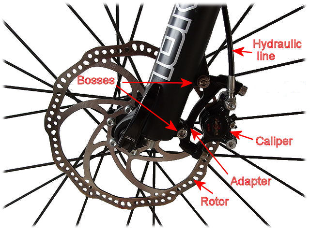

  5. Dunerunner
    Or, this...
    chelloveck and arleigh like this.
  6. arleigh
    Hydraulics in stead of cable is a great idea.
  7. BTPost
    Just as long as you don’t spring a Leak....
  8. arleigh
    If you knew the punishment mountain bikes endure especially on down hill racing ,you'd choose hydraulic over cable too.

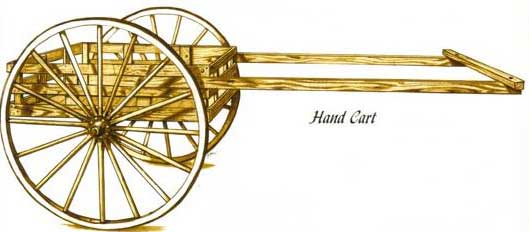

  19. DKR
    Polymule - RESERVE NOW
    I guess they do these in batches. The site videos are worthless as they are all shown in static positions, not in use.
    How about getting the real deal?
    Mormon Hand Cart - Amish Wares
    $900 USD but has steel wheels, square axle and bearings. See link for full description. 4X4X1 foot beds.
    The 'real carts came in more than one size...
    Brokor and Zimmy like this.
