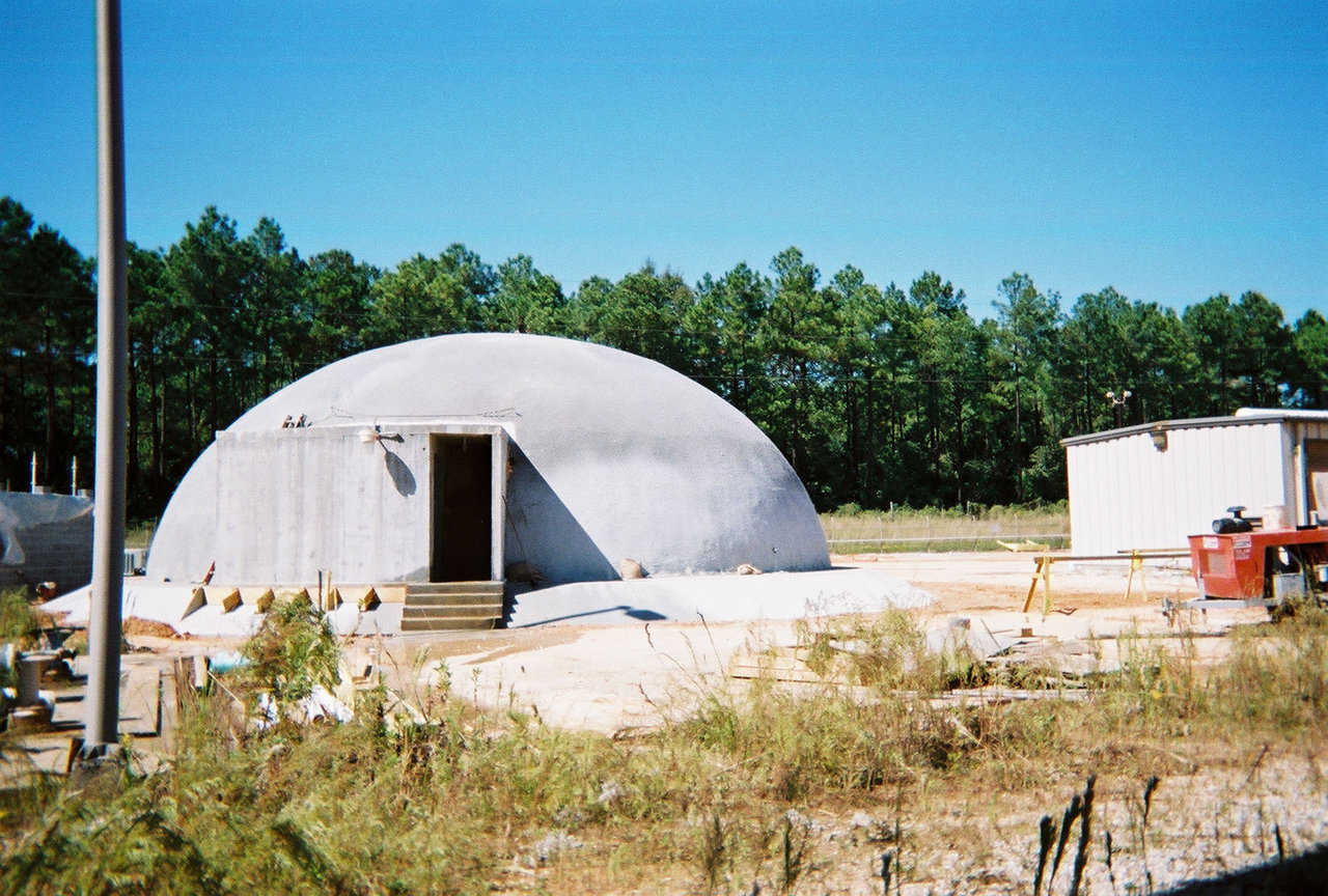

  12. BTPost
    If I lived in a place subjected to High Winds (Hurricane, Tornado, etc) I would be looking at a structure that was NOT capable of being a WING… and constructed from rain proof materials, like concrete… Maybe a Dome Shaped outer structure solidly anchored to a couple of driven steel pilings down to bedrock if possible.. and once built, covered with a couple of feet of compacted soil… If you look at all the news pictures of buildings, trashed by that kind of Storms, they were all truned into WINGS, and blown to bits by the pressure gradients imposed by those winds…If there is nothing for the winds to work on, they mostly pass right on by…

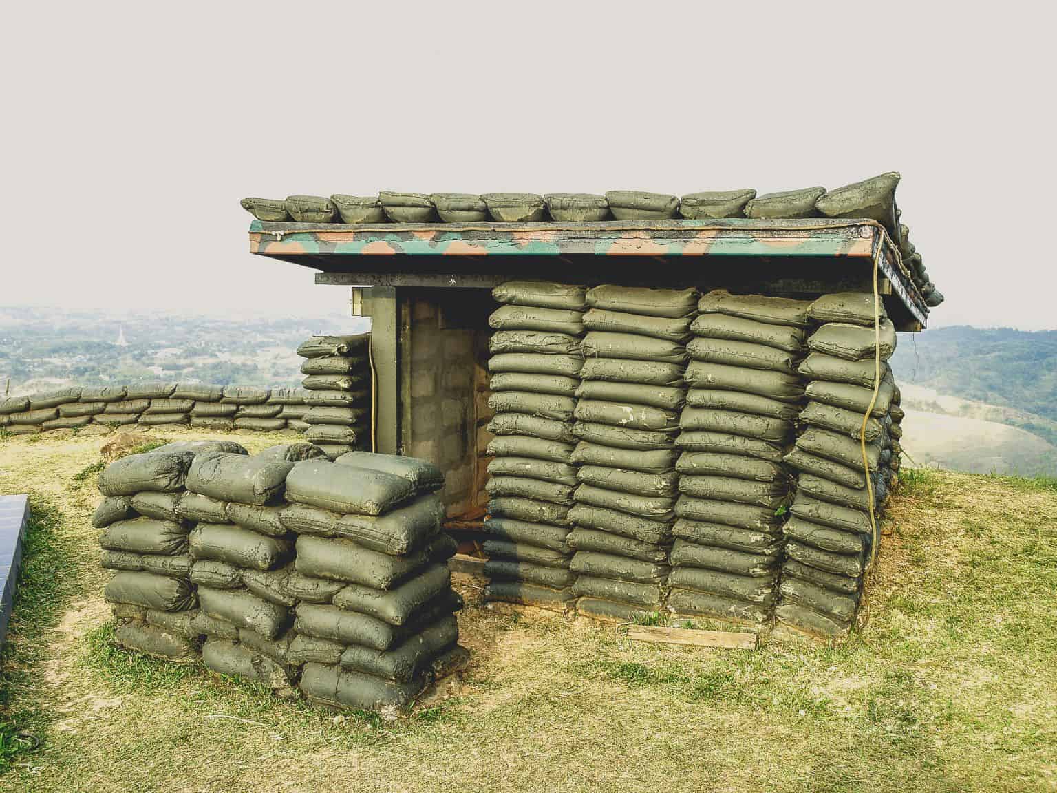

  18. DKR
    Wall?
    Dude, make a hooch...
    mechstdr, Zimmy and CraftyMofo like this.

  20. BTPost
    That Sandbag roof would last 10 seconds, in any sustained wind, like a Hurricane or Tornado… it would be a tiny bit better if it was Flat, rather than at that angle… It is nothing but a WING, waiting to fly…
    Now the Dome building on the other hand, is not going to fly anywhere…
