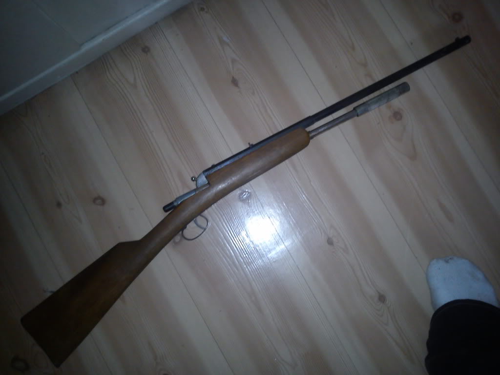

    This is one of my rareties, a Swedish made "Excellent" multi-pump pneumatic from 1956 in the odd caliber 5.4mm roundball. When the .22 short was banned for hunting here anyone with a garden and some veggies they cared about got an air rifle so there's quite alot of old pretty looking air rifles in circulation.
    Sorry 'bout the sock. Wife left. With all my best socks.
