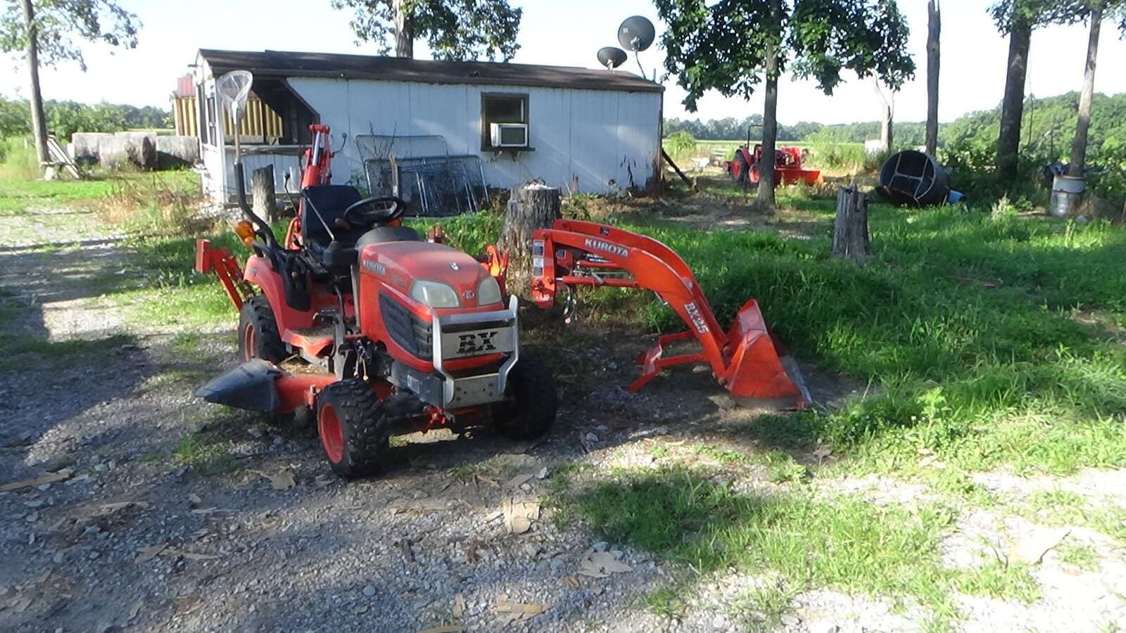

    LOL was mowing along sideways on the West slope of what we now call Maple Hill, its a slope that is just on the safe side of the line to mow sideways across. I had my R14 tires on the little tractor which are great dry ground traction tires. A little down pour came down and I just kept mowing through it, it was at most going to be a 10 minute rain with blue skies to the west behind the clouds.
    Got to the end of the strip I was mowing and the R14s had collected enough surface mud to turn into racing slicks and we slid sideways all the way down the slope to edge of the deep channel. The Channel is where we mined all of the clay for the Key and core of the lake dam and is a pretty consistent 12-14 feet deep with a pretty much straight drop to those depths from the banks. So the soft mud on the edge stopped the tractor slide but it was still slowly sliding into the lake. I had enough time to drop the backhoe stabilizer arms and extend the backhoe out to the East and bite it into solid clay. I have the loader off and on a trailer to get some repairs done at a welding fabrication shop Tuesday, so had nothing on the front end to drop and bite in.
    I made the mile walk back to the Shop and got the M5660, a chain and pinned the clevis onto the draw bar and flew back out to the lake. While I was away the front end continued sliding and pivoting and the front end and engine were now under water with back hoe bucket starting to lose its grip in the clay bank. I booked it chaining onto the backhoe bucket , not the ideal place to chain onto for pulling but I was in a hurry LOL. Got the chain through the clevis and hooked just as the backhoe gave up its grip and the BX made a 8" lurch forward snapping the chain tight. Would not have been purdy if I had been a second slower and got a hand or fingers pinched in the chain. BX with the backhoe on weighs around 3500 pounds more than enough weight to make a chain cause pain. Slowly inched the BX back, I really did not want to bend the stabilizer arms when they hit something more solid than mud.
    As I had hoped would happen the stabilizers bit into solid clay and caused the front end and engine to tilt up and out of the water. I let it hang there for a few minutes shedding water and climbed over from the back and popped the hood and pulled the air filter out, it was totally saturated but not much water went down the air intake. So I started it, fired right up and raised the stabilizers half way and slowly retracted the backhoe pulling the BX another 3 feet out of the water or rather over the water. It looked like it was parked on the water. I then disengaged the hydro tranny and went back to the M5660 ( had the brake set and big chocks behind both back tires.) Put it in creeper gear and slowly pull the whole BX back onto dry land. Back to the BX and engaged the tranny, set the brake and unchained and then drove it to a nice safe flat spot. Parked the bigger kubota M5660 on top of Maple Hill and drove the BX back to the shop. It at a minimum needed a new air filter. Somehow got a good amount of water in the oil and a little water in the hydraulics.
    It was getting dark so I called it a day and went out this morning and changed the engine oil and the hydraulic oil and gave them both new filters. Also explored why so much water got into the engine oil. And finally found the reason, the O Ring on the dipstick was gone and let the water seep in around and down the dipstick hole. How it got into the hydraulic oil remains a mystery for now, it is a sealed system. Unless there is a vent somewhere I am missing, it was only a couple of tablespoons worth of water VS the engine oil having about a quart of water in it.
    A major and expensive disaster averted the BX25D is older (2012) but would cost around $35,000 to replace. If it had slid all the way in and down it would have been at the bottom of a nearly straight drop under 12 feet of water. It would have taken some a lot bigger than anything I have to lift it up out of that and I suspect would not be cheap. The R4 Industrial Bar Tires are going back on. They shed Mud Very well and have 1000X better traction in mud than the R14s do. Where the R14s shine is their much better traction on dry ground but they do not shed mud for shit! If I had the R4s on I could have turned into the slide and had enough bite to steer away from the lake. The R14s packed with mud I may as well have been riding a well waxed sled on ice. The R14s are a great general use tire that doesn't tear the ground up on turns like the R4s do and they give you the traction to push and pull 600-800 more pounds than the R4s and probably are the the best tire selection for most property owners. They are not so great if you are going to be getting into wet and mud on a regular basis.

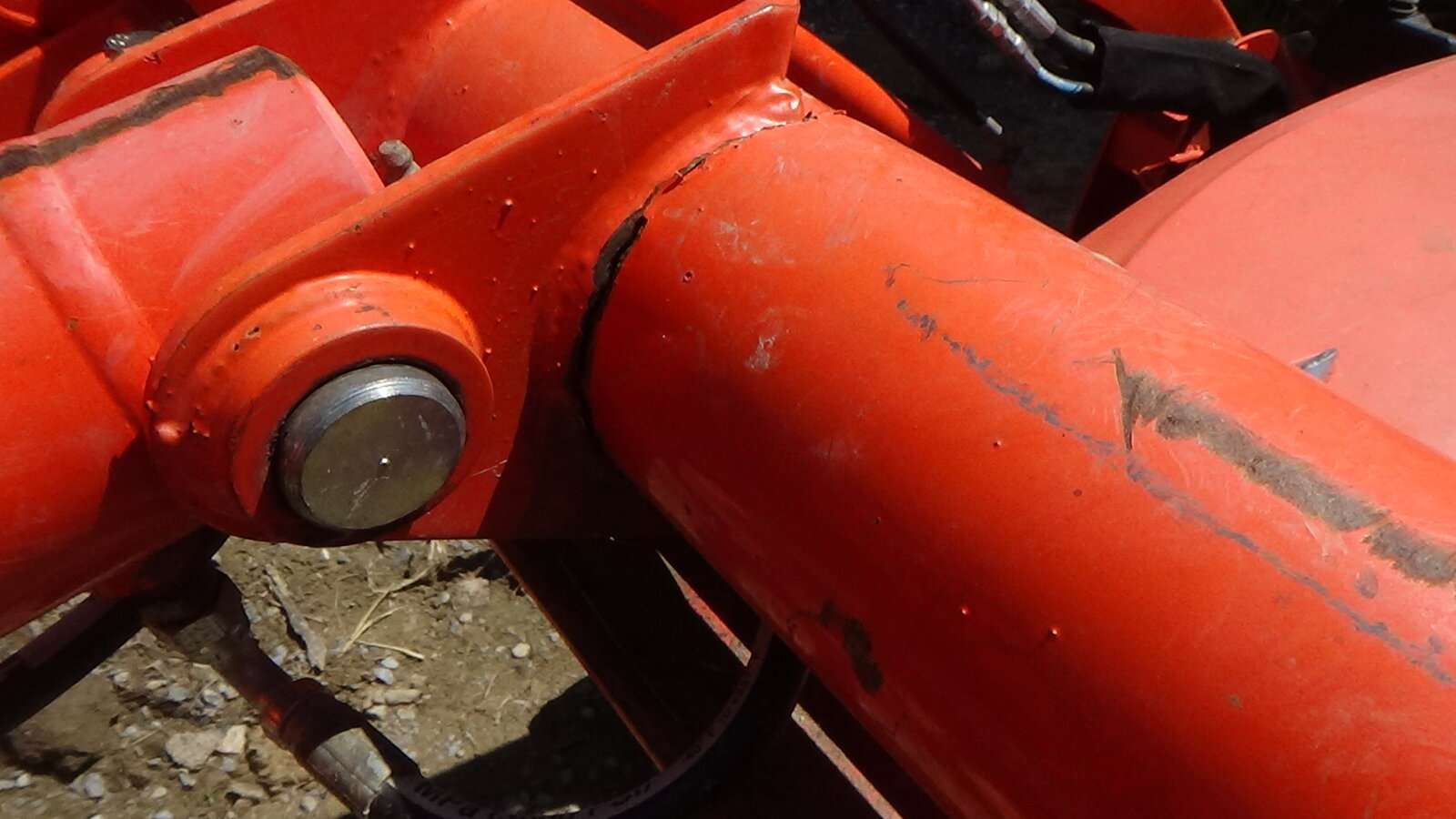

    I abuse the hell out of the little BX25D and break the bar between the arms about every 2-4 years on the loader. It is actually designed to break so the much more expensive arms don't bend or break and it is only about a $500-$700 part to have fabricated and the broken one cut off and the new one welded on depending on which shop I use. Considering I push 4000 pound logs around with it (Yes I have beefed the hydraulics up and the push power, I modify pretty much everything after it is out of warranty. LOL the loader and BX are rated for lifting 500 pounds, my suit case weight mod and the beefed up hydraulics let me lift 1200 pounds with it. The arms and sub frame are reinforced and the tube between them is heavier gauge than factory but still breaks before the arms can be damaged. )
    Sure would have been nice to have the loader on the tractor last night, It makes a fine emergency brake and also would have stopped the slide pretty quick. But there it sits waiting to go to the shop. I changed the back tires back to the R4s this morning, LOL need to locate the front R4s, things got moved around in the shop and the back tires got separated from the front tires. And it appears I missed the top of the hood when I blew the mud covering off. And yep I cut the ROPs off, it gets real old getting slapped with branches on the back of the head when mowing the orchard and the ROPs would catapult a apple that would knock you silly. My Bug and Little fish net is much more functional. And well there is no place here I can roll the BX over to need the ROPS. Also why I NEVER take the BX to a Kubota Dealership for work. They always want to put a new ROPS on and I just ain't gonna have that! It would not be so bad if mine was not the one model year and model that they put the ROPS that don't fold down on, it was a solid piece and I cut it off about where they typically fold back. And ran a wire between them to hang my clothes on to dry when I can't resist jumping in the lake to cool off :) LOL not uncommon to find me mowing in my underwear waiting for the pants and shirt to dry. Sometimes I remember to shed the clothes before diving in, sometimes its just so hot there ain't time for that!

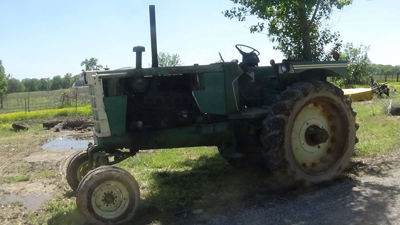

    I keep eye balling the new BX23s I like a lot of the features but I sure don't like their price tags. For Whatever reason the 2012 BX25Ds Came with solid non folding ROPS My 2001 BX22E has folding lol and I cut the bolts off it and removed the ROPs on it to, got old raising it everytime I used the backhoe. Talked to a friend that is a Kubota Dealership Mechanic about the BX23s and according to him you can mod the hydraulic pressure, engine power and tranny like you could with the older Kubota BXs and the 3 safety switches are more complicated to disable, guess you can just unplug them and make U copper wire and stick in them now. And they have EWWWWW Computer Chips in them! So I will keep the 22 and 25 running forever :) I can add some of the newer features like the much better 3pt hitch and the belly mower mounts and connections but those parts are on the expensive side.
    I do like the R14s when pushing and pulling just wish they shed the mud out of the tread better. The R4s just dominate the R14s on soft or muddy ground. I went with the narrow R4s on the M5660 and have only gotten it stuck when I was building the lake and hit a patch of bottomless mud.
    When the new machines break or get stuck Oliver is there and just keeps on going.

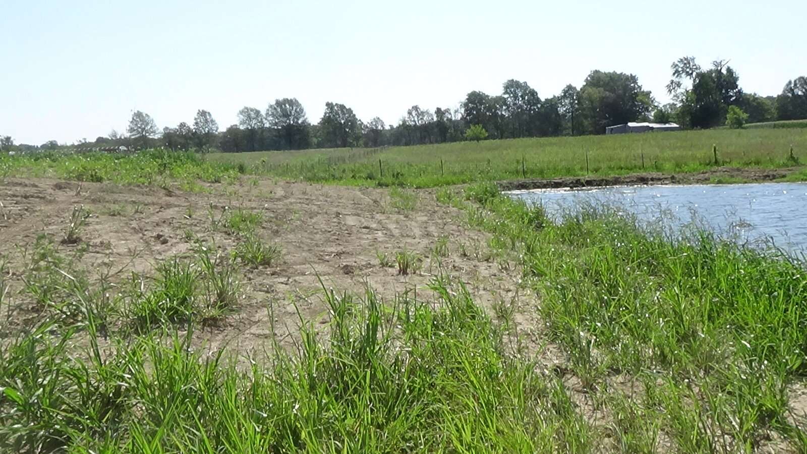

    Slope is not bad it is actually a pretty gentle slope and you would have to work pretty hard to roll a low center of gravity tractor over on it. That being said it is steep enough to slide sideways on and build momentum on the 150 foot trip to the bottom :) I would not put a tractor like Oliver with a high center of gravity on it, that would not be so hard to lay it on its side.
    This is the South side slope of Maple Hill South/West/North all have the same gentle grade. It is a artificial hill made from all the clay and top soil taken out of the South Arm of the lake to make depth. The top is 250'x300' I planted a couple dozen red maples around the edges and closer to fall will rough it up and seed it heavy with K31 grass. Right now it is Johnson Grass, Rag Weed and Cockle burrs LOL. I keep all mowed down every couple of weeks to keep it from making seed. The East side slope is not so gentle I mow it with the BX but that is straight down mowing and drive around and go down again because it is to steep to drive back up. But not so steep that the weeds can't root in and grow good. Right now a dirt road goes behind the East side slope/cliff. Next year I am going to build a 3rd pond in the low area in the background of the picture. I already built the clay key under the dirt road for its dam. I am going to rent a dozer for a Month to do it. LOL I proved my point last year that a big pond and dam can indeed be built with a 57hp tractor and a 6' box blade...... It just took 4 Months of 14-16 hour days to get it done. A Cat D6 with a 6way I can have the top soil pushed out in 3 -4 days and the clay pushed to the next dam and compacted in about 10-12 days and have another 6 acres of water above the lake. I have a couple of other decent size dozer jobs that will take up the remaining couple of weeks of the rental. Local Cat Dealership rents older trade ins out at very reasonable rates. Dozer will be around $3500 for a Month, Might rent the 313 or 314 trackhoe they rent out for $2500 per month to be consort to the dozer and teach a friend how to operate the dozer. The next pond will go a lot faster with me digging with the excavator and him pushing it with the dozer. Anyway the dam will eliminate the East side slope cliff on Maple Hill and be pretty much level with the top. And still be a East-West road on top of the dam.
