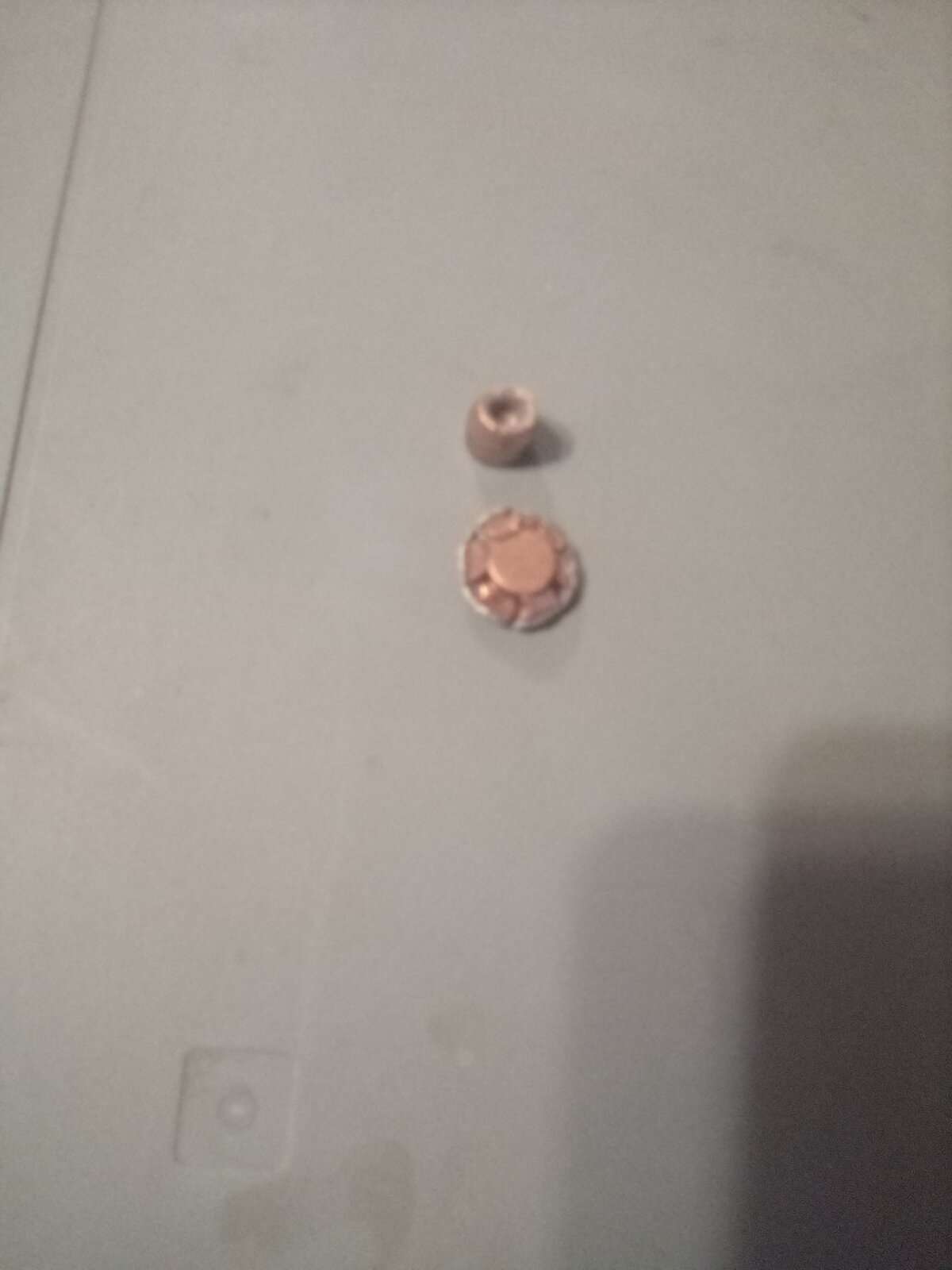

    IMG_20240413_231615_4.
    Both bullets are 90gr xtp intended for a 380acp, loaded in 9mm. Same load of powder for both and fired from the same barrel, before and after rifling. The unfired looking bullet hit a water jug sideways or backwards the other is the same kind of bullet from the same box, fired on a ballistic trajectory into water jugs.

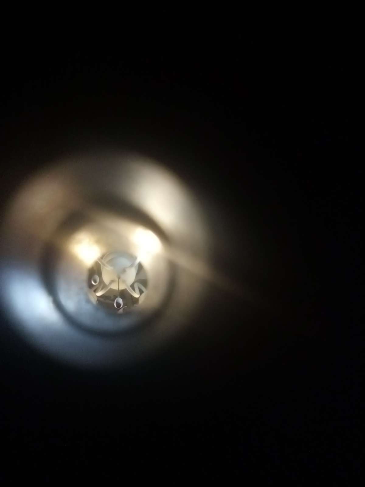

    IMG_20240413_231302_7.
    Before rifling looking up at my fan.

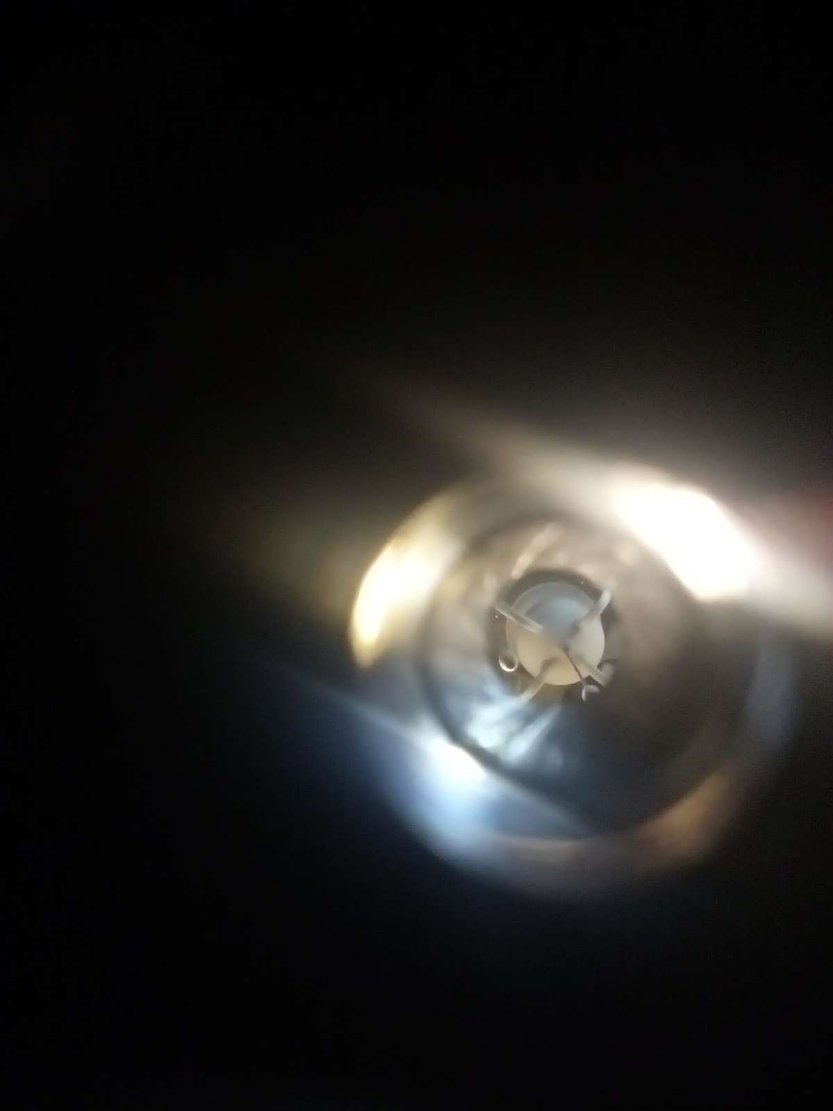

    IMG_20240413_231459_7.
    After rifling. Its rough, but it's there and it works.
