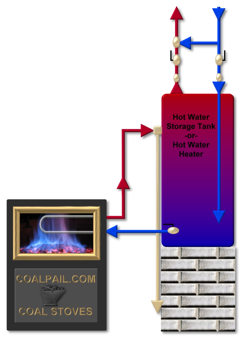

  4. chelloveck
    The sled micro cabin needs to be portable, and having an internal source of heat may not be practicable in some circumstances. Also the heat source needs to be at a lower elevation than the storage for the siphon effect to work, as I understand it.
    Thermosiphon Loop | Coalpail.com
    SB21 likes this.
