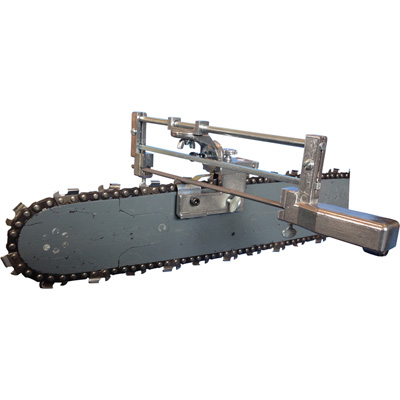

    OK....I'll admit, I'm a sucker for chainsaw sharpeners. Over the years, I've bought a Granberg File/guide attachment, went back to a plain file, then a 12v Granberg chain grinder (like a Dremel tool), then went back to a file, then a bench mounted Harbor Freight grinder (really didn't like that one) , and back to a hand file.....the only thing I've improved a hand file with is a file guide like this Oregon one.....like the wood handle, and angle marks....keeps you hand filing pretty good.
    SO, when I ran across the Timberline sharpener at Bailey's, I had to try one. Wife got it for my Xmas present, and I've tried it out over the last few days....have to say I'm really impressed....fast, easy to mount/use/dismount, does a great job on grinding, gets every tooth to the same angle and length. I think this one is a keeper.

    Pretty cool, and seems simple enough. Does it come with different sized carbides for different sized chains ?

    Like what I am seeing so far, but it looks to be very time consuming and not able to be adjusted for differing chain pitch or for grinding the guides! I use the Stihl Professional chain sharpening system A LOT, but find my self having to do quite a bit by hand, specifically the Ripper Chains I run, these have a unique tooth design, and have to be done by hand, and chain life is very short! For my smaller yard saw, this might be a pretty good tool, I wonder if finer carbides can be had?

    Yeah, they have different carbides for various chain sizes.

    Watched the video and was really impressed so looked up on Amazon to purchase. It has very good reviews on Amazon, 4.5 stars.
    The price is much more than I thought it would be, ~$130, but looks good.

  7. TnAndy
    Yeah, Bailey had them on sale for 99 bucks before Christmas, and I got it then. The cutters are about 20 bucks each, but being carbide, my guess they will have a pretty long life.

    I have the Sears equivalent. Works well, but is NOT heavy duty.

    Looks nice, but at that price point I'll stick with my files for touch-ups and chainsaw sharpener (disc grinding wheel) for really dull chains. For how often I need to sharpen a the chainsaw, I don't think it's worth it. I'm like BT, I have a hook for dull chains, when I get to one sharp chain left, I pull out the grinder and sharpen them all.
    Does that sharpener allow for different angles on the teeth? I have 2 chains that are rippers for cutting logs into boards with a mill.
