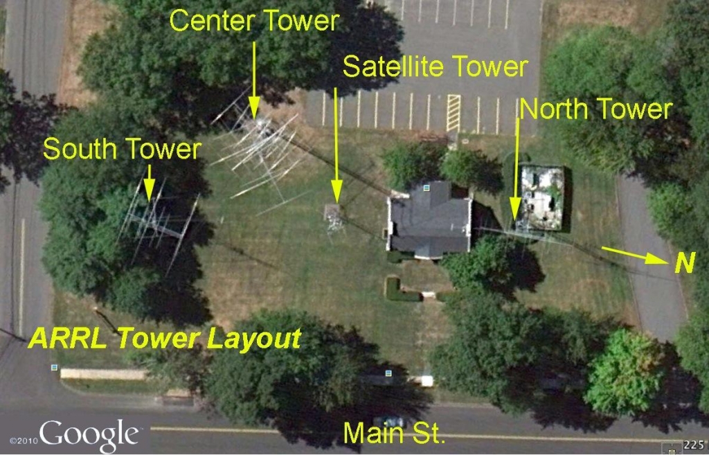

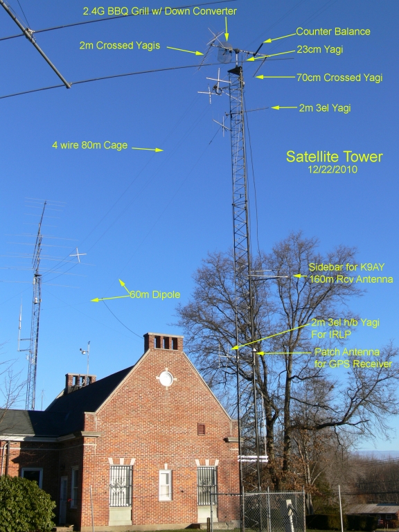

  6. Tully Mars
    GOOD GAWD thats a lot of hardware!!
  7. Yard Dart
    Looks to me like a city set-up for multi-jurisdictional communications.... maybe?!
  8. ghrit
    Maybe W1AW in CT, dunno for sure --
  9. Yard Dart
    Very nice regardless ;)
  10. Airtime
    Airtime Monkey+++
    Holly hardware, Batman. That first one is indeed at ARRL's W1AW station. Here is an overhead view:
    The bottom image was some fellow's rig that Google found: W4FOT.com Home Page
