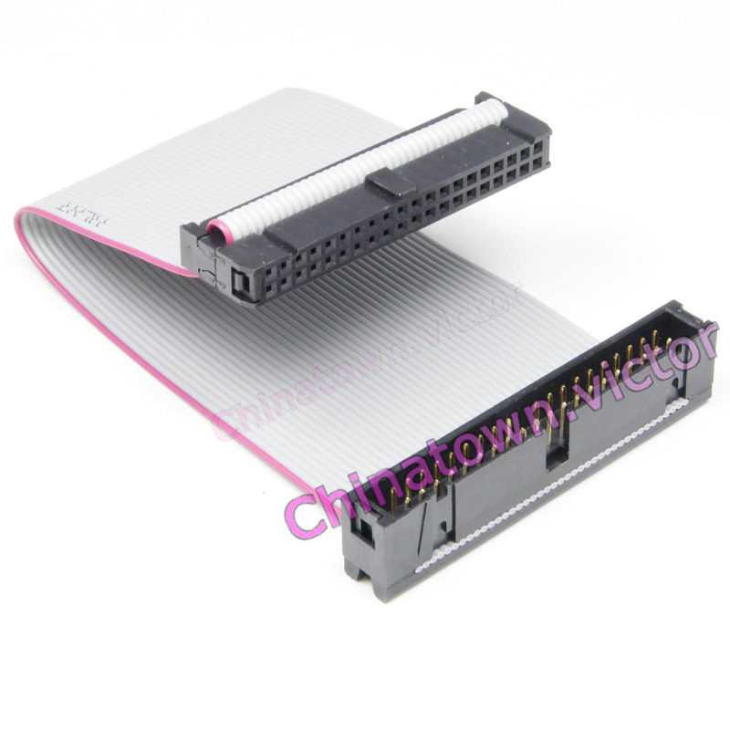

    OK, I have a drive that I need to recover, was in a laptop, took it out and put it in a external case, usb, but no luck, what is this interface cable you all are talking about, haven't tried an exact same drive and swapping the electronics yet., but that sounds promising.
    Rancher
  15. Dunerunner
    It is the 40 pin IDE serial "Ribbon" cable within your desktop or tower PC that connects the HD to the Motherboard.
  16. Bandit99
    Bandit99 Monkey+++
    I wasn't talking about the cable but the interface itself. So, you put the raw drive (only the drive) into an external case and the pins matched up? Did any lights come on? I was talking about something like this (see link) but I don't know what type of drive you have. But, if your external case matches up and provides power then that should have worked. Drives do fail but mostly when they are bumped, dropped or something to cause the head to touch the plate, most the time it is all the other electronics that fail. I have only had one disk drive fail me in my career that I can remember and, strange enough, it was a 1 TB Seagate Barracuda (which Seagate replaced) but had 2 others that ran perfectly for years until I dumped them...in fact, I think they are still running.

    40 pin has all but disappeared
