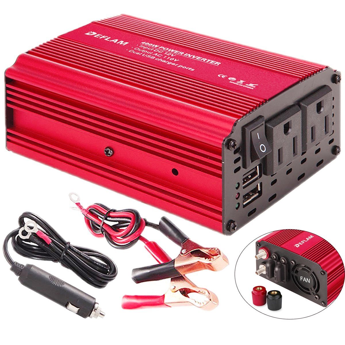

    1. The inverter is a POS. I've already had to have the two outlets replaced. The power button is already busted from my fingernail turning it on/off. I know it saves power to turn it off every night. My question is: will it wear out faster if I do that?

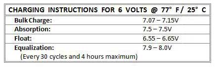

    (Equalization is a big deal)

    The inverter is a pure sine wave unit rated at, I believe, 1Kw (1000 watts)
    It really wasn't designed to be switched on and off a couple of times a day - a lot of systems have a DC cutoff, However, it doesn't hurt the inverter to be cycled on and off - if there is no load. So, turn off anything plugged in before switching off the inverter..
    The red unit - being only 300 watts has a low 'overhead' or idle current. I didn't list part numbers, as I don't know if it can even be found on the island... The point was to see if, in the interim, you can even find a lower wattage inverter as a possible replacement when your unit finally bites the dust.... Quite literately, to take your fan along and have the salesperson prove a (possible replacement) lower wattage unit can handle the load...
    For a fan and a LED light, I would be surprised if you needed even a 500 watt unit.

    This translates to about 0.3 amps of current - well less than half of the idle current of your inverter.

    Everything still off - Voltage at the battery terminals. Should be 12.6 VDC (plus of minus a bit) on a good and fully charged battery. below 11VDC may indicate a problem - MAY. Wait till we see the measurements.

    Voltage at the battery terminals - should be around 13.8 to 14 VDC.
