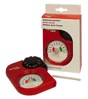

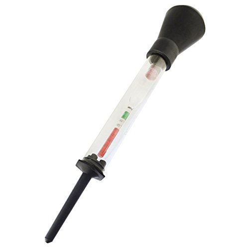

    At the full point, there is a ring within the cell which causes the liquid surface to dimple. A battery filler will shut of flow automatically, but if you are using a bulb syringe to fill you will have to visually see the level. It is good to use a flashlight shone into the cell to assist in seeing the level.
    The Hydrometer...
    Bulb Syringe for Battery Water...
    Automatic battery water filler...
    techsar and chelloveck like this.
  17. Cruisin Sloth
    Mr dune
    Your first picture has the floating gauge in the tube upside down .
    Please correct that so many will not load that in that way .
    Hydros need to be washed in Dist/Water to keep clean & working .
