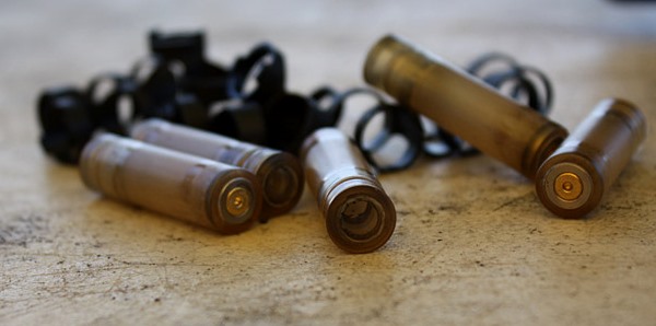

    LSAT’s cased-telescoped 5.56mm ammunition relies on a plastic case rather than a brass one to hold the propellant and the projectile, like a conventional shotgun shell. It weighs about 37 percent less than standard belted 5.56mm.

    Polymers can easily be engineered to have higher melting temps than 'plastics'. Not sure about the specifics on the casing in question but certain polymers have more of a glass like crystalline structure and hardness and tend to decompose at higher temp rather than melt. Polymerization was one of the more interesting subjects covered back in Organic Chemistry!
    Watching a few other videos about the LSAT shows that they are developing a completely 'caseless' ammo where all materials but the projectile itself are expended at firing. Seems this tech has been around for a great many years but has not really been utilized to any degree so far. Caseless has its pluses & minuses. No picking up piles and piles of brass and then storing, cleaning and sizing it. Very nice feature! But impossible to roll one's own... At least until the materials and equipment are made available & affordable. I personally can't wait for the day caseless is the standard. Definitely some obstacles to overcome before that day arrives though.
    Currently, AK-47/74 steel cased rounds are polymer coated. They are the greyish looking cases as apposed to the lacquered OD green cases. The polymer coating undergoes a liquification process that seals the chamber at time of firing. It does not melt. I have fired a gajillion (technical term for a lot!) through my 7.62 AK with nary a hiccup. But then I have also fired at least 3/4 of a gajillion lacquered cases through my 5.45 AK with the same zero issue reliability. Anecdotal evidence to say the least!
    I've heard many horror stories of people having major issues running lacquered stuff through standard 5.56 uppers. And even a few issues with running it through 5.56 chambered AK's. Can't recall hearing many complaints about running the polymer cased stuff through standard 5.56 AR's other than the usual complaints about how dirty Russian ammo is and the usual fouling associated with it and the business end of the gas piston in both AR's & AK's.
    Not sure how a completely polymer case might behave vs a polymer coated steel case though. Can't find much technical and test detail yet so am not sure what process they are using to build the polymer chains. Interesting subject though. Some days 1/2 of me wishes I had taken the chemical engineering path... The other half of me is always happy i didn't though! [stirpot]
