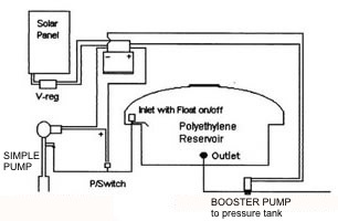

  13. Cruisin Sloth
    NO WAY is that one solar panel making that motor work . .
    The battery he said amp hrs , is the driver .
