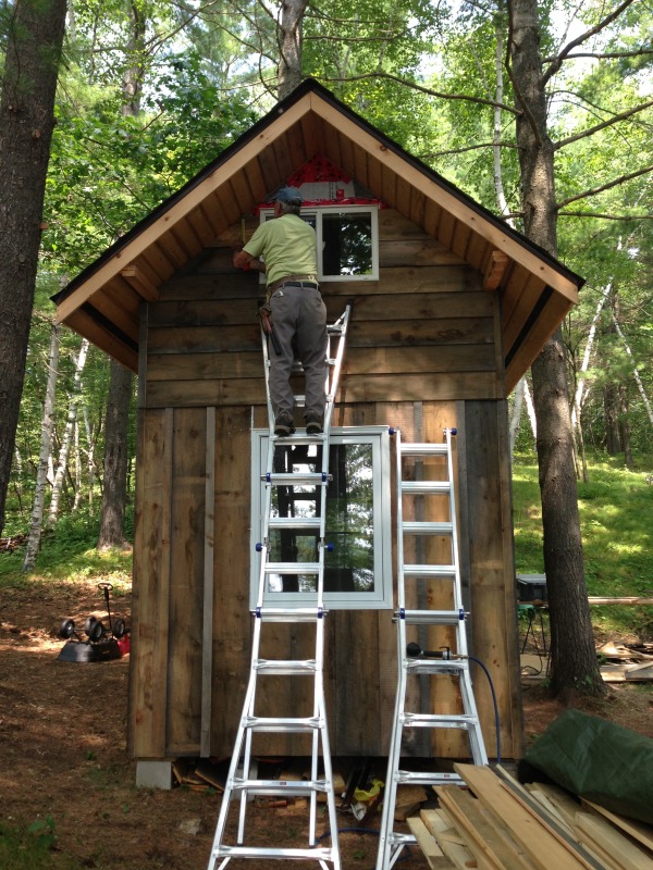

    We are just finishing up a no-permit, off grid, water access only cabin.
    It is wired for power, and so far we have a Honda eu2000 generator giving us power when we need it.

    Just looking at the posted pix I SEE Trees = SHADE .
    Where is this Cabin Cap Canuk ? Mine is on Vancouver Island , solar & airtight Power & heat . No cell , TV maybe if it's clear but we don't waste power to hear bubble heads , Radio but the cabin is for if the weather changes & a storm hits. There is a sign in the cabin , replace the food you ate and stay safe . A few know it & have used it. My coldest might be -10c MAX for a few days , & if the battery's are charged , they don't freeze but power output is low.So they are under the cabins floor buried in the dirt for cool Solar panels are in the skylights facing south . Power is for led light, to read ! Lots of books up there & if you take one you owe two in return ! Out house also has an LED with outside lighting to it. Basic storm shelter . Bears & wolves have been there , but if the place is keep food in cans sealed & MT cans removed when you leave seems they can't read. 12 volt system , all for just leds & to charge the GPS , radios using a buck converter if i need higher voltage . Main switch shuts all power off But Solar to battery is always charging daylight.

    @Capt.Canuck - @Cruisin Sloth beat me to it but the very first thing I thought when I saw that cabin was "Where are you going to put those solar panels because there ain't no sun around that cabin and dapples of sunlight obviously won't cut it?" Are you planning on doing some/a lot of pruning/thinning?
    Again, not to rain on any parades but without more info that corrects my initial gut reaction, I would say I didn't see how it would work. Could it, conceivably, in theory? Yeah but I don't see how "as it sits".
