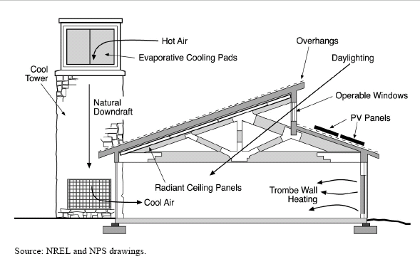

  18. DKR
    a passive cooler tower
    is popular in the desert SW. As part of a whole house system, it saves considerably on heating/cooling costs
    These are also very low energy-use systems.
    Merkun likes this.
