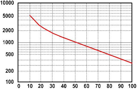

  13. Airtime
    Airtime Monkey+++
    There is not much difference in the chemistry of the various types of the lead acid batteries. The differences are structural and that shifts the discharge and life curves around but the fundamental shape of the life curves are very similar. So you may find one version of lead acid can handle a 50% discharge 1000 times and another might only tolerate that 400 times before significant compromise is noticeable. But none of them are going to have a longer life being repeatedly discharged 50% than repeatedly discharged just 10% of their full capacity. This is because the dimension that ultimately kills a leaf acid battery is chemical; the structure just changes how quickly that occurs as some can mitigate or slow the effect vs. others. Go looking and you'll find they all have a curve rather similar to the following. The difference will be the numbers across the x axis will be offset and/or scaled differently but the shape will be similar. An occasional discharge to 50% won't be very significant either way affecting positively or negatively the sulfating or uneven redeposition of lead.
    I don't consider myself a battery engineer or expert either by any remote stretch. Sadly, I am an EE (geek is spelled with two e's for a reason I've been told!) and some years ago was involved as the program manager for a product requiring extensive battery power and we went through all this very stuff. I've seen some of these very curves again in the last few months at work with some engine controls that stop an engine at a traffic light and then restarts it within 1/2 a second and less than 3/4 of a revolution from the moment the throttle pedal is depressed to go. They are using battery sensors that mount directly on the battery post that assess voltage, current, temperature and state of charge and then talk over a CAN datalink to the engine controller. The engineers assessed if there were specific battery recommendations to be made, hence their looking at battery data.
