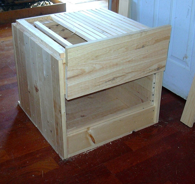

    If this hive is for your hunting land and you wont be able to check on them every week, consider a Peronne. Install the bees and forget 'em for 18 months. Ideally you stock with a prime swarm, I've had great luck adjusting the design to put a NUC in.
    Here's where the NUC option looks like:
    [​IMG]Peronne hive with window & NUC option
    You don't need the window, of course.
    http://keepingwiththebees.wordpress.com/
    explains the system and has plans to download.
    Of course, you could do a langstroth and manage it like a Perone. If you don't mess with it every week, that's what will happen anyway.

    The Hive Body [​IMG]
    The standard 10 frame Langstroth hive body will vary from dealer to dealer. The inside dimensions are critical. Depending on the thickness of the wood, the inside dimensions are: 9 19/32 inches from top to bottom, 14 11/16 inches from side to side for the front of the box, and 18 5/16 inches from side to side for the side of the box. A rabbet is provided on the top side of the box fronts for a resting place for the hanging frames. A great advantage of this type of hive box is that more boxes with the same dimension can be stacked one above the other and the bees will move up into the upper boxes and store honey there.

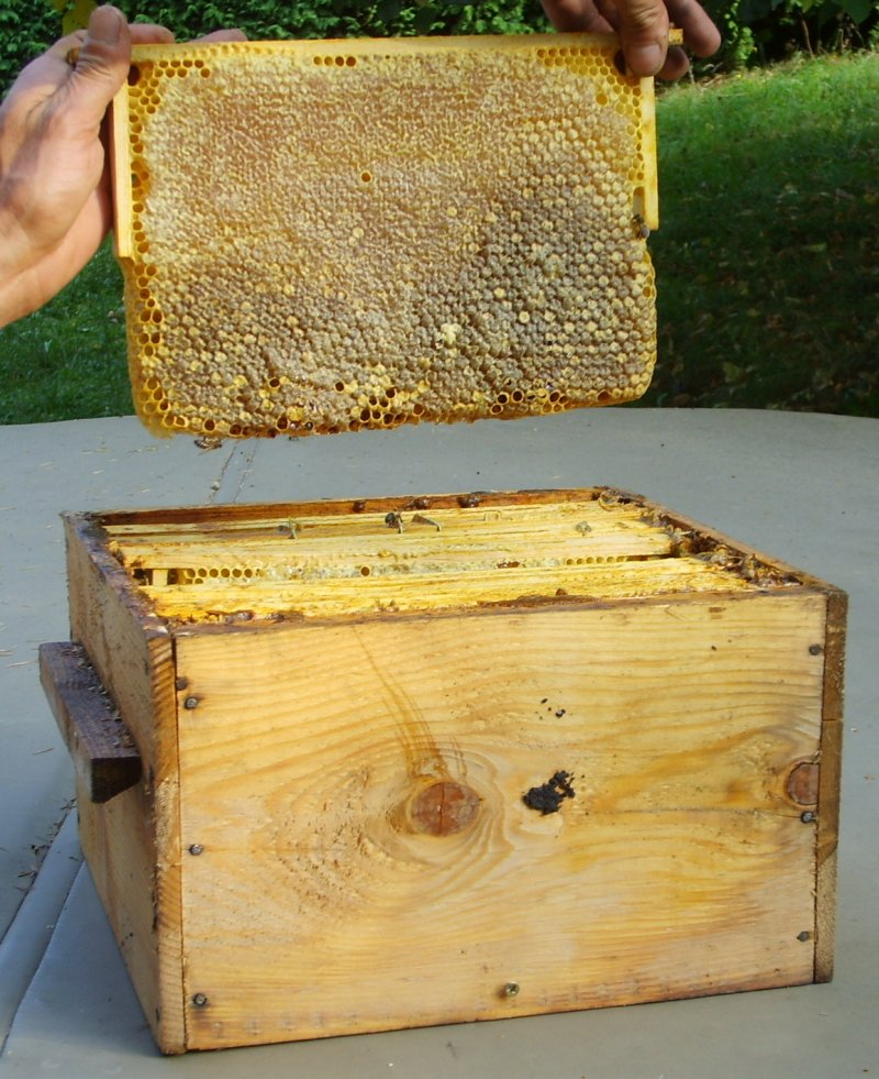

    These are the boxes with frames and foundation for the bees to store surplus honey. They come in four basic sizes.
    • The shallow 5 3/4 inch super that uses 5 3/8 frames.
    • The medium (Illinois) 6 5/8 inch super that uses 6 1/4 inch frames.
    • The deep 9 9/16 inch super that takes 9 1/8 inch frames
    • Comb honey supers**
    **Comb honey supers are 4 3/4 inches deep. They require special supplies to produce the comb honey. The beekeeper has the choice of the old standard section boxes that require section holders, separators, flat tins and springs. Or the beekeeper can use what are called "Ross Rounds". In a Ross Round super the bees build comb into round section rings. Our advice to a beginner is to pass on the comb honey sections until you have a year or two experience. It takes strong bees and special management to produce good comb honey sections. If you really want comb honey, a easier way is to use the standard shallow frame with thin wax foundation and when the bees have capped the honey in the frame, you can cut sections of it out and put it into freezer bags or jars. One will find clear boxes or cut comb honey trays in the bee catalog which can be used to sell cut honey.
