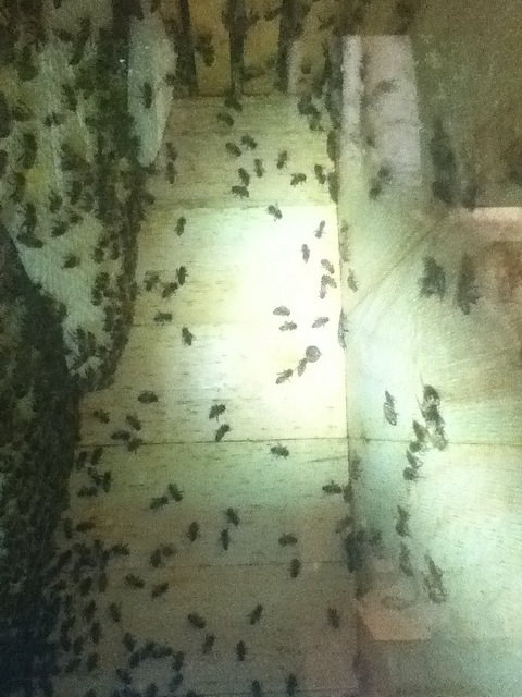

  9. cjsloane
    cjsloane Monkey
    Almost filled up. The rest of the space (2x2x2) is totally filled top to bottom.
    Still haven't given them access to the honey supers.
