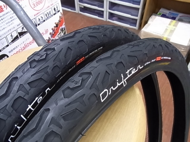

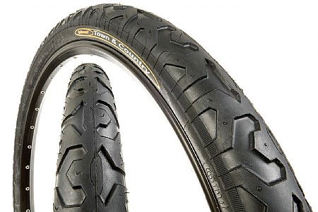

    Inverted tread tires like the Serfas Drifter which are currently on my Big Dummy) or Conti Town & Country are also great choices for a mix of pavement and trail.
