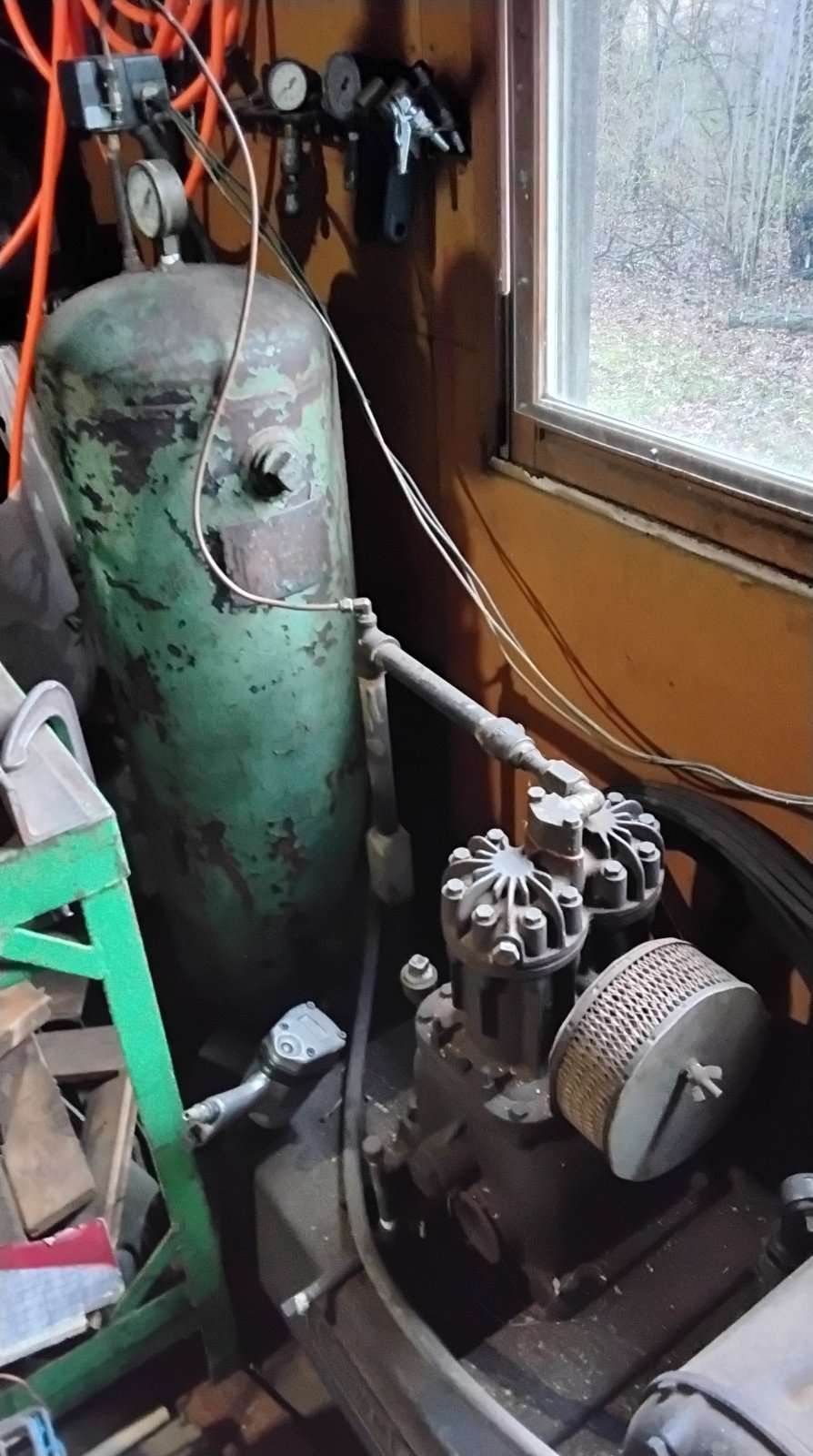

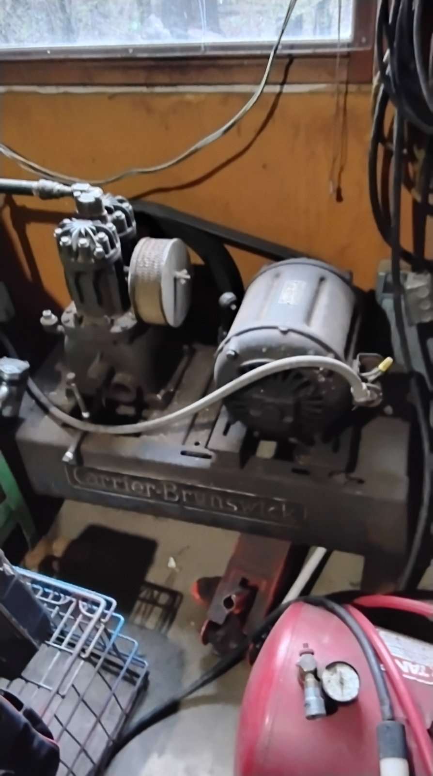

    Here's my air compressor it's about 100 years old and still working. It was a Carrier Brunswick refrigeration compressor. The motor is 1 1/2 hp repulsed and induction motor. The motor runs at 1700 rpm the compressor turns at 440 rpm great piece of history. 20260410_081907. 20260410_081913. 20260410_081907.
    Tempstar likes this.
